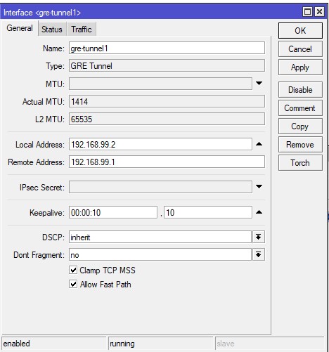

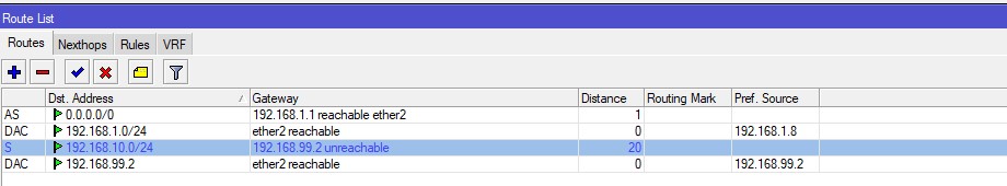

I´ve done this Configuration.
But on Route List it shows “192.168.99.2 unreachable”
Could someone help me, please ![]()
