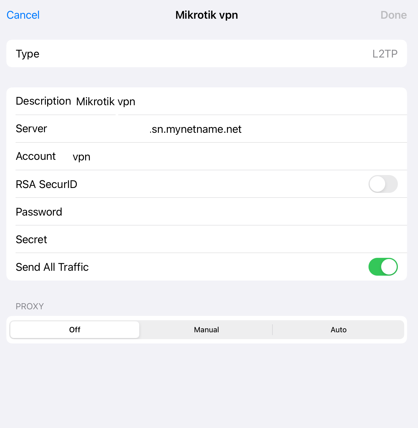

I set up a VPN using Quick Set on my home router a few weeks ago. The tests I conducted at home with an iPad connected to the internet via my phone’s hotspot were successful. However, when I tried to connect from abroad (GR) using the VPN, it didn’t work. I also attempted to use my phone’s hotspot and the hotel’s Wi-Fi network, but without success. Strangely, when I returned home and retested, it worked.

This is what i did in the router Quick Set and ipad. Nothing else.
