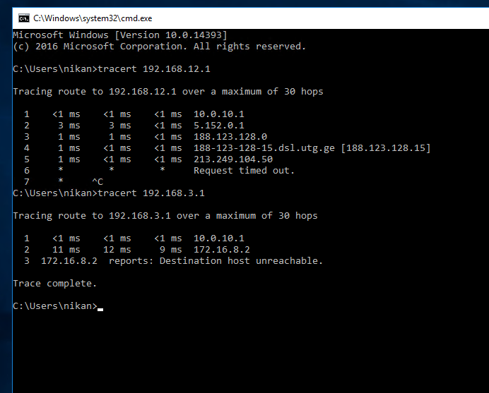

I have 2 router and they ar connected with VPN (L2TP connection, Server and User)
1st router - 10.0.10.0/24
2st router - 192.168.12.0/24
When I am run tracert 192.168.12.1 from server, it goes outside of VPN and if IP is 192.168.3.1, it works correctly (see attached)
I can’t understand what’s wrong.
P.s 192.168.3.0/24 is also connected with VPN at same router.
