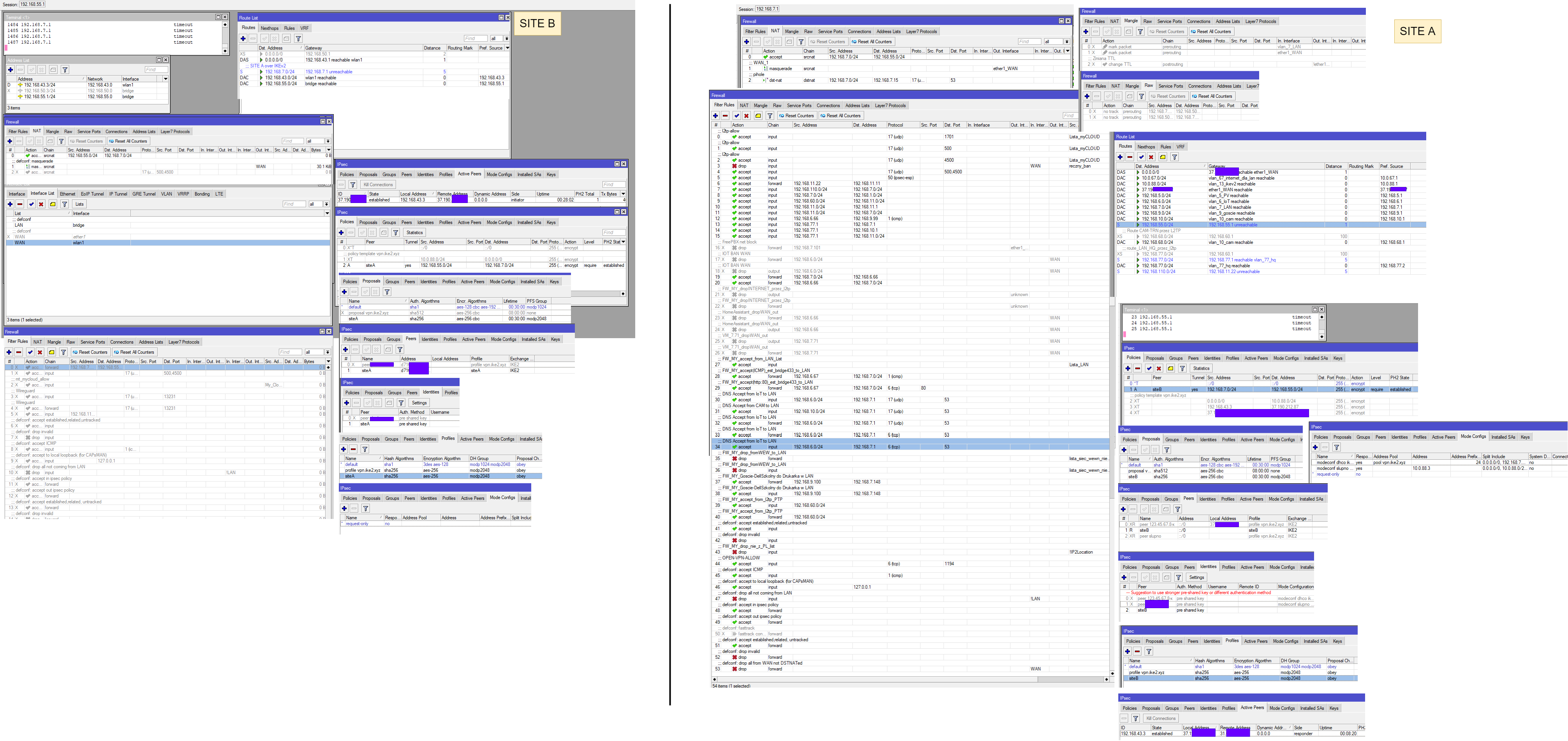

SITE A - vlan7 - LAN+mgmt (192.168.7.1) main router, DHCP server, firewall, L2TP VPN server (192.168.11.1 - currently disabled), IPSEC VPN (10.0.88.1). Ethernet 1 is as WAN and gets public address as DHCP client.
SITE B - no VLAN, only bridge on eth 1,2,3. 192.168.55.1 (no DHCP server), L2TP VPN client (disabled) 192.168.11.33, now VPN CLIENT (10.0.88.3). WLAN1 (wifi) connects to a simple LTE router (without management options) and receives an address from dhcp 192.168.43.3, i.e. it is behind NAT.
The situation is as follows. I have a network at home (Site A) and the main hAP ac2 router (ARM) in it. I want to connect to a remote Mikrotik hAP mini using IPSEC VPN. Both work under ROS 6.49.7.
So far I’ve used PPP/L2TP connection with IPSEC and everything worked as I wanted. SITE B connected as a client to SITE A (192.168.11.1), got the address 192.168.11.33. It was enough to set the routing and both networks were reachable without any problems (of course with the appropriate rules on the firewall).
Now L2TP has been completely disabled on both sides so that it doesn’t conflict. Now the situation with IPSEC looks more complicated. SITE A is the Server with the address 10.0.88.1, site B gets the address 10.0.88.3. (I was based on Mikrotik Wiki and MUM2019 by Nikita Tarikin).

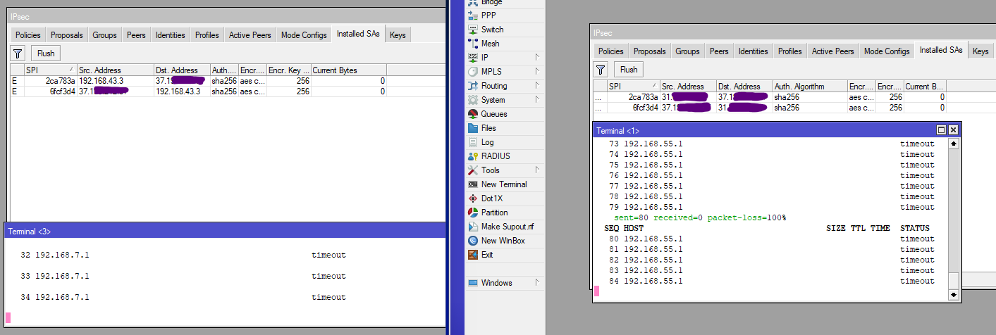

The connection is established correctly, but there is a problem. And now:
SITE A can PING → 10.0.88.1 , 10.0.88.3
SITE A cannot PING → 192.168.55.1 (its LAN address of SITE B)
SITE B can PING → 10.0.88.1, 10.0.88.3, 192.168.7.1 and others from this network, e.g. 192.168.7.4, which is how it is supposed to work.

    src-address=192.168.7.0/24
add action=accept chain=srcnat disabled=yes dst-address=10.0.88.0/24 \
    src-address=192.168.55.0/24
add action=masquerade chain=srcnat disabled=yes dst-address=192.168.55.0/24 \
add action=masquerade chain=srcnat comment=WAN_1 ipsec-policy=out,none \
    out-interface=ether1_WAN
add action=masquerade chain=srcnat out-interface=ether2 src-address=\
    192.168.7.0/24
add action=dst-nat chain=dstnat comment=pihole dst-address=192.168.7.15 \
    dst-port=53 protocol=udp src-address=192.168.7.0/24 to-addresses=\
    192.168.7.15
add action=masquerade chain=srcnat comment="NAT DO SITEB" disabled=yes \
    dst-address=192.168.55.0/24 src-address=192.168.7.0/24
/ip firewall raw
add action=notrack chain=prerouting disabled=yes dst-address=192.168.55.0/24 \
add action=notrack chain=prerouting disabled=yes dst-address=192.168.7.0/24 \
/ip firewall service-port
set ftp disabled=yes
set tftp disabled=yes
set irc disabled=yes
set h323 disabled=yes
set sip disabled=yes
set pptp disabled=yes
set udplite disabled=yes
set dccp disabled=yes
set sctp disabled=yes
/ip ipsec identity
# Suggestion to use stronger pre-shared key or different authentication method
add disabled=yes generate-policy=port-strict mode-config=\
    "modeconf dhco ikev2pool" peer="peer 123.45.67.8-x" \
    policy-template-group="group vpn.ike2.xyz" secret=SECRET
add generate-policy=port-override mode-config="modeconf SITEB static ip" \
    peer="peer SITEB" policy-template-group="group vpn.ike2.xyz" secret=\
    SECRET
/ip ipsec policy
add comment="policy template vpn.ike2.xyz" dst-address=10.0.88.0/24 group=\
    "group vpn.ike2.xyz" proposal="proposal vpn.ike2.xyz" src-address=\
    0.0.0.0/0 template=yes
#WAN 0.0.0.0/0 (add default route from dhcp CLIENT)
add distance=1 dst-address=192.168.55.0/24 gateway=10.0.88.3
add disabled=yes distance=15 dst-address=192.168.55.0/24 gateway=\
    192.168.11.11
add distance=1 dst-address=192.168.55.0/24 gateway=192.168.11.33
add disabled=yes distance=1 dst-address=192.168.55.0/24 gateway=10.0.88.3
SITE B
# model = RB931-2nD
add admin-mac=DC:2C:6E:DD:AF:19 arp=proxy-arp auto-mac=no comment=defconf \
    fast-forward=no igmp-snooping=yes name=bridge
add comment=defconf name=WAN
add comment=defconf name=LAN
add authentication-types=wpa2-psk eap-methods="" mode=dynamic-keys name=\
    "4g usb" supplicant-identity="" wpa2-pre-shared-key=WIFILTEPASSWORD
/interface wireless
set [ find default-name=wlan1 ] band=2ghz-b/g/n country=poland disabled=no \
    distance=indoors frequency=2437 installation=indoor security-profile=\
    "4g usb" ssid="4G UFI-9211" wireless-protocol=802.11
/ip ipsec policy group
add name="group vpn.ike2.xyz"
/ip ipsec profile
add dh-group=modp2048 enc-algorithm=aes-256 hash-algorithm=sha256 name=\
    "profile vpn.ike2.xyz"
/ip ipsec peer
add address=DDNSMIKROTIK-SITE-A exchange-mode=ike2 name=\
    "peer SITE-A server" profile="profile vpn.ike2.xyz"
/ip ipsec proposal
add auth-algorithms=sha512 enc-algorithms=aes-256-cbc lifetime=8h name=\
    "proposal vpn.ike2.xyz" pfs-group=none
add comment=defconf disabled=yes interface=ether1 list=WAN
add interface=wlan1 list=WAN
add address=192.168.55.1/24 interface=bridge network=192.168.55.0
/ip cloud
set ddns-enabled=yes ddns-update-interval=5m
/ip dhcp-client
add disabled=no interface=wlan1
set allow-remote-requests=yes servers=192.168.50.1,1.1.1.1,8.8.8.8
/ip dns static
/ip firewall address-list
add address=DDNSMIKROTIK-SITE-A comment=MT_SITE-A list=My_Cloud_MT
add action=accept chain=input disabled=yes src-address=192.168.7.0/24
add action=accept chain=input disabled=yes dst-port=500,4500 protocol=udp
add action=accept chain=input comment=mt_mycloud_allow disabled=yes \
    src-address-list=My_Cloud_MT
add action=accept chain=input comment=Wireguard disabled=yes dst-port=13231 \
    protocol=udp
add action=accept chain=forward comment=Wireguard disabled=yes dst-port=13231 \
    protocol=udp
add action=accept chain=input disabled=yes src-address=192.168.11.0/24
    established,related,untracked disabled=yes
    invalid disabled=yes
add action=accept chain=input comment="defconf: accept ICMP" disabled=yes \
    protocol=icmp
    "defconf: accept to local loopback (for CAPsMAN)" disabled=yes \
    dst-address=127.0.0.1
    disabled=yes in-interface-list=!LAN
    disabled=yes ipsec-policy=in,ipsec
    disabled=yes ipsec-policy=out,ipsec
    connection-state=invalid disabled=yes
    connection-state=new disabled=yes in-interface-list=WAN
add action=accept chain=srcnat dst-address=192.168.55.0/24 src-address=\
    192.168.7.0/24 to-addresses=192.168.55.0/24
add action=accept chain=srcnat disabled=yes protocol=udp src-port=500,4500
add action=masquerade chain=srcnat comment="defconf: masquerade" disabled=yes \
/ip firewall raw
/ip ipsec identity
add generate-policy=port-strict mode-config=request-only peer=\
    "peer plock server" policy-template-group="group vpn.ike2.xyz" secret=\
    SECRETPASSWORD
/ip ipsec policy
set 0 disabled=yes
add comment="policy template vpn.ike2.xyz" dst-address=0.0.0.0/0 group=\
    10.0.88.0/24 template=yes
add distance=2 gateway=192.168.55.1
add distance=1 dst-address=10.0.88.0/24 gateway=10.0.88.1
add comment="SITE-A over IKEv2" distance=5 dst-address=192.168.7.0/24 gateway=\
    10.0.88.1
add comment="SITE-A over L2TP" distance=10 dst-address=192.168.7.0/24 gateway=\
    192.168.11.1
add distance=1 dst-address=192.168.11.0/24 gateway=192.168.11.1
add distance=1 dst-address=192.168.55.0/24 gateway=192.168.55.1
/ip service
set telnet disabled=yes
set www address=192.168.7.0/24,192.168.11.0/24
set ssh disabled=yes
set api disabled=yes
set api-ssl disabled=yes
/system clock
set time-zone-name=Europe/Warsaw
/system identity
set name=MT_SITEB
/system ntp client
set enabled=yes primary-ntp=153.19.250.123 secondary-ntp=178.252.19.225

Sob, Thank you very much for your reply and your time. Of course, I’m probably fussing too much.
I uploaded the configuration from you and the IPSEC tunnel connected without a problem. Unfortunately, the pings do not fly, this time from both sides. I am posting screenshots from the mikrotik configuration.
I tried with your configuration with the firewall turned off on both sides - the result is the same
Those blue unreachable routes to remote subnets (on both routers) are wrong. Right now I’m not sure (temporary brain outage :wink:) they are breaking it, I think they shouldn’t. But you don’t need them, so they can be removed. You can also check if IPSec counters are increasing (in IP->IPSec->Installed SAs) when you’re trying to ping something remote. But I don’t see what’s blocking it.
Sob, thank you so much for your attempt to help, I really appreciate it :slight_smile:
I removed redundant routing, broke the IPSEC connection using Kill Connection. SAs cleared and after reconnecting, the values ​​on the screen appeared. I ping both sides, unfortunately no change.
Current bytes = 0 means that nothing is sent or received. But if you’re pinging from router, it’s expected, you need to set source address, because it’s choosing wrong one:
/ping src-address=192.168.55.1 address=192.168.7.1
It’s working!
Thank you very much for your help and time!
