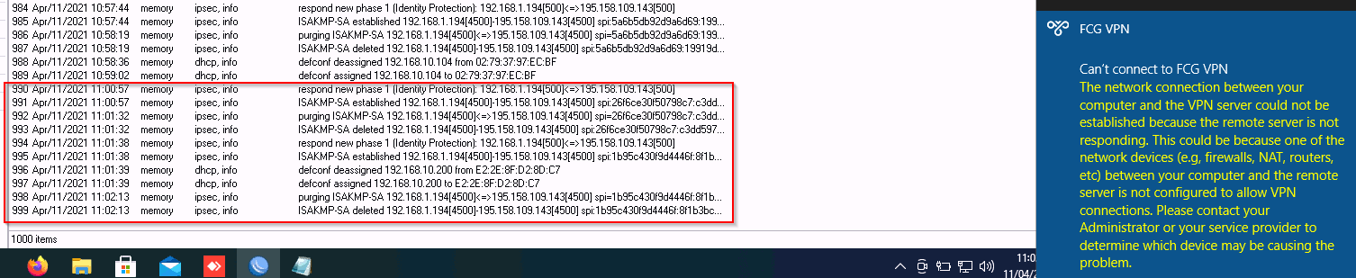

When I test the VPN I can see that it’s reaching Mikrotik via the firewall rules/hits and logs, however according to logs the connection gets established, but then, the ISAKMP-SA key gets deleted.
