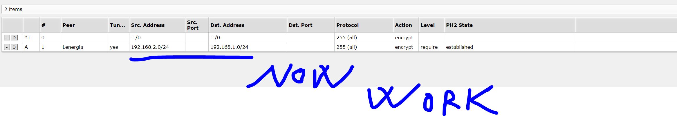

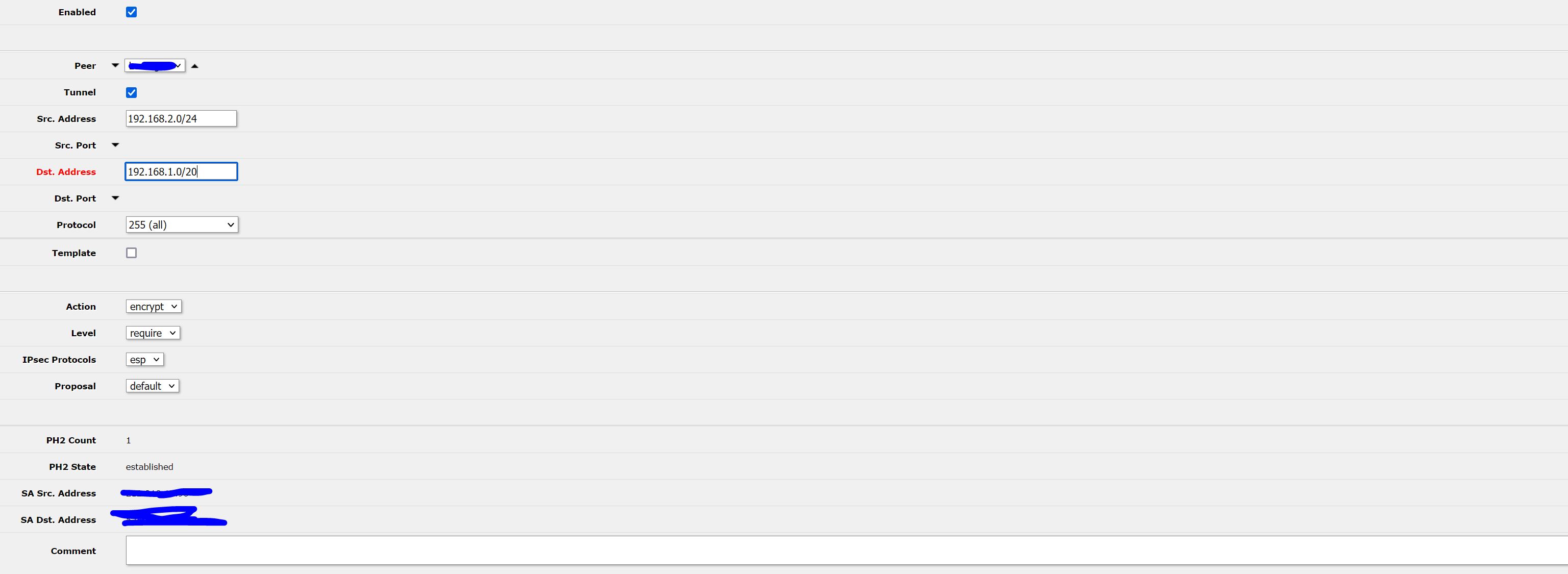

Unfortunately, with this netmask from site 2 I cannot access the PCs of site 1, it seems it is not possible to set the destination 192.168.1.0/20 on the Mikrotik.
I attach Screen
Address of network that has /20 mask and includes 192.168.1.x is 192.168.0.0/20. But it also includes 192.168.2.0/24 that you have on other side and it’s likely to cause problems.
