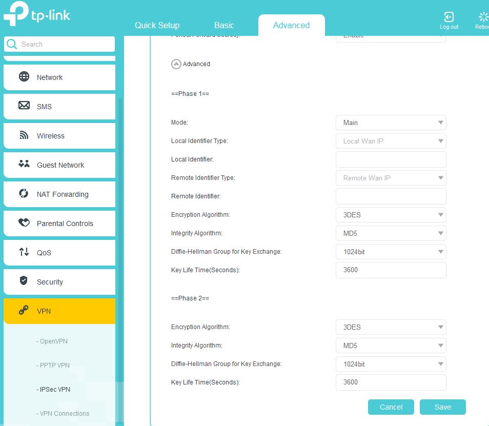

I want to connect from a TP Link MR6400 router to RouterOS with VPN IPSec.
I always get error: no suitable proposal found

Proposal in RouterOS = phase 2 elsewhere, so make sure you have matching parameters.
Now I have all parameters. But now I receive “phase 1 negotiation failed due to time up”

What is the problem?
Now it looks like there are only outgoing requests, but not a single response coming back. As if it couldn’t connect at all.
Did you go to this part of the TPLink config and ensure it matched with the Mikrotik?
