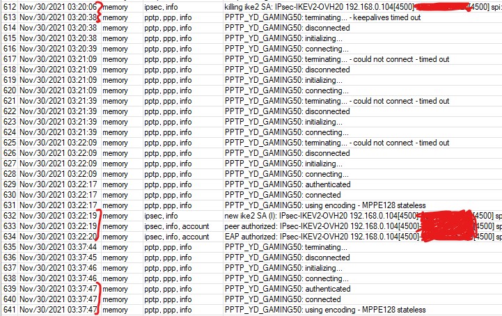

  1. how is traffic is routing now? I’m asking this because when the IPSec is down PPTP is not connecting (if connected it will got terminating) when the “IPSec is killing ike2 SA” before it’s get a “new ike2 SA (I)” for about 120 seconds PPTP is just trying to connect and if you remember I had a “IPsec-SA expired before finishing rekey” problem before you told me on another topic to set /ip ipsec proposal to pfs-group=none and it’s fixed that “IPsec-SA expired before finishing rekey” problem but still there is “IPSec is killing ike2 SA” and I got a feeling this is a server configuration problem (Linux Ubuntu StrongSwan).
  2. Is this normal to having “IPSec is killing ike2 SA”? It’s not very frequent though it’s like at three days once or every other day.

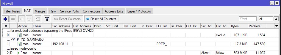

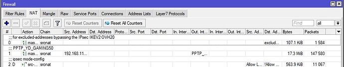

This means the explanation may have been nice but actually it wasn’t clear enough. So again.
The very purpose of adding connection-mark=no-mark to the mode-config row is that instead of rule order in the srcnat chain, the presence or absence of a connection-mark would decide which packet will be handled by which rule - so there would be no need to move the rules around, using a scheduled script or otherwise.
My way, there will be just three rules in chain srcnat:
first, the dynamically added one:
action=srcnat src-address-list=“Allow Local DNS” connection-mark=no-mark to-addresses=the.ip.from.responder
second and third, in any mutual order, the static one for traffic leaving via PPTP and the static one for the traffic leaving via the regular WAN (ether10 in your case):
add action=masquerade chain=srcnat comment=PPTP_YD out-interface=PPTP_YD src-address=192.168.11.94
Their mutual order is irrelevant because no packet can match both out-interface=PPTP_YD and out-interface-list=WAN (unless you’d make PPTP-YD a member of interface list WAN; if you did, the single rule matching on out-interface-list=WAN would be enough, but please don’t do that as it might break something else in the firewall). The dynamic rule must be first, though.
To make the dynamically created rule ignore a packet, you have to assign some connection-mark (no matter what particular value it will have) to that packet.
Since you want packets matching on dst-address-list=excluded-addresses to be ignored by the dynamic srcnat rule, you must add a
dst-address-list=excluded-addresses action=mark-connection new-connection-mark=avoid-ipsec
rule to /ip firewall mangle; to make it “safe”, i.e. to make sure it would only assign a new connection-mark value if none has been assigned to that connection yet, it should also match on connection-mark=no-mark or connection-state=new.
And my mistake was that I’ve written nat/prerouting and nat/output whereas the correct places are mangle/prerouting and mangle/output.
A rule in mangle/prerouting handles traffic forwarded from LAN; a rule in mangle/output handles packets sent by the Mikrotik itself, such as the PPTP transport ones.
If there is no rule in mangle/output (my way) or in nat/srcnat (your previous way) that would exempt the PPTP transport packets sent by the Mikrotik itself from being src-nated to match the dynamically generated IPsec policy, it means that the PPTP transport packets to the remote PPTP server are sent via the IPsec policy. So when the Security Association (SA) linked to that policy is down, but the policy itself still exists, the PPTP transport packets get nowhere, as the policy diverts them but cannot actually deliver them.
It indeed looks like some incompatibility between the initiator and the responder, or maybe it indicates a huge data loss causing the rekey procedure to fail, ot maybe it’s the refresh of the “control SA” (the one the peers use to negotiate and control establishment of the SAs carrying the payload) that fails. To say more, I would have to see the logs from both peers, including about 5 minutes before the “killing ike2 SA” messages appear in the log.

Since it doesn’t happen regularly, I doubt it is a plain configuration issue, rather a timing issue in one of the the protocol stack or packet loss. But audit of configuration is never harmful :slight_smile:

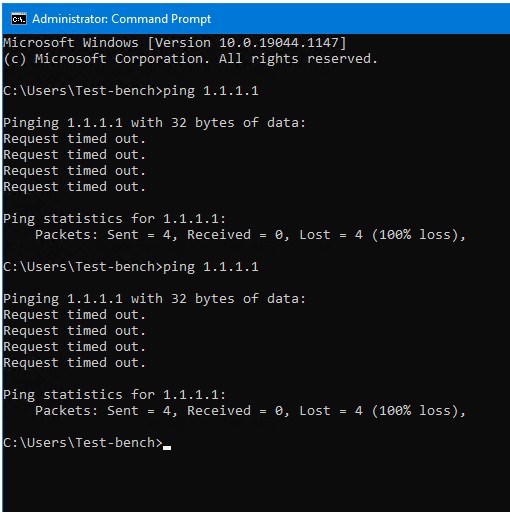

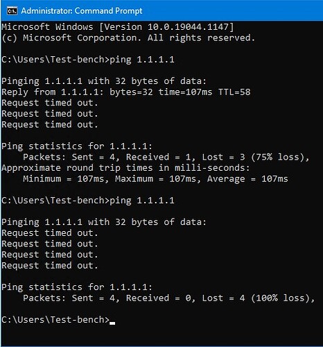

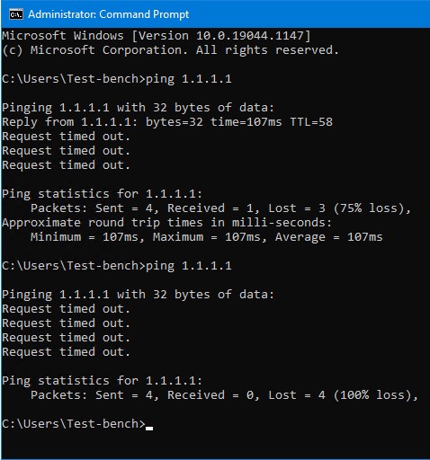

It’s like the very first packet only get routed (if I close the cmd (or just simply open another one) and ping again, again the first one will receive):
Sorry, I’ve got lost when reading the rules you’ve posted, they are indeed a 1:1 copy of what I’ve suggested to set, so the problem with different chain names in different rules doesn’t exist (I should have chosen some better name of the chain that wouldn’t conflict with the rule action name).
Is the action=fasttrack-connection rule in filter disabled? And are you sure that the first ping goes via the PPTP tunnel (use /tool sniffer quick interface=PPTP_YD_GAMING50 to check that when pinging from the PC)? Because I’ve currently got no idea what may cause the first ping request and response pass fine but the next ones to fail.
The idea is that the first packet of the ping sequence matches on connection-state=new so it goes to the mark-connections-prerouting chain and there it gets the connection-mark PPTP_YD_GAMING50; after that, the processing of the packet continues by the first rule after the action=jump one, and this rule should assign it the routing-mark PPTP_YD_GAMING50 since the connection-mark assigned by in the other chain is PPTP_YD_GAMING50. The next ping request belonging to the same sequence skips the action=jump rule (as it doesn’t match connection-state=new), but it nevertheless matches the action=mark-routing one because it gets the connection-mark in connection tracking (before getting to mangle/prerouting).
NP problem man, thanks for keeping up.
It’s not pinging anymore now -.-’ I don’t know why
