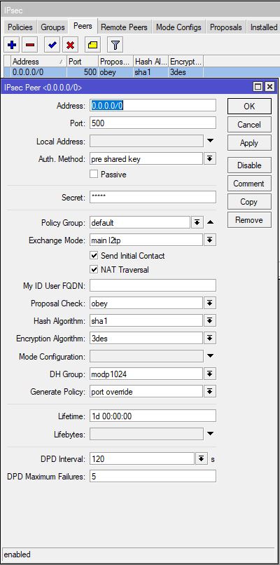

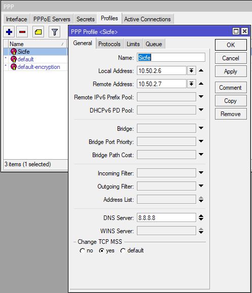

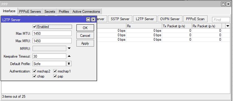

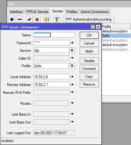

I’m having some trouble to setup a VPN L2TP in one of my current Mikrotiks because of it’s version (6.11) for sure! The plan is to replace that RB1100AHx2 for a RB1100AHx4 Dude Edition, but right now it’s impossible to do that migration.
I’ve been looking for a tutorial, guide, post or anything like that in all the blessed internet, but nothing it’s based on the 6.11 version, so, everything refers to options that I don’t have and for them, works just perfect.
I’ll post some captures of the actual configuration and wait for you to tell me what’s wrong. Do have in mind that for some easy thing, I’ve changed some options to see if it works, but till now, couldn’t make it happend.

What does /interface l2tp-server export show (not interested in your password)?
[Update]
My settings in l2tp-server are:
/interface l2tp-server server
set authentication=mschap1,mschap2 default-profile=l2tp-profile enabled=yes \
    ipsec-secret=******** max-mru=1460 max-mtu=1460 use-ipsec=required

Hi erlinden!
This is the print result
/interface l2tp-server server>> print
enabled: yes
max-mtu: 1450
max-mru: 1450
mrru: disabled
authentication: pap,chap,mschap1,mschap2
keepalive-timeout: 30
default-profile: Sicfe

In regards to the error, please have a look at my (working) configuration:
/ip ipsec profile
add dh-group=modp4096 enc-algorithm=aes-256,aes-128 hash-algorithm=sha512 name=\
    secure-profile
/ip ipsec proposal
set [ find default=yes ] enc-algorithms=3des
add auth-algorithms=sha512 enc-algorithms=aes-256-cbc name=secure-proposal pfs-group=\
    modp4096

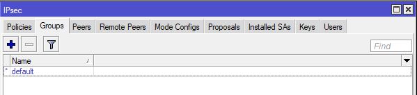

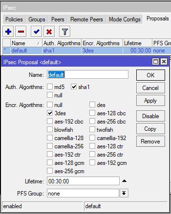

Hi erlinden,
Here is what I have inside IPsec...can't find the "profile" you mention. In my first post are the rest of the captures of the configuration. As long as you have a newer version of the routeros, you see/have things that I don't, that's why I'm in this forum right now jeje.
