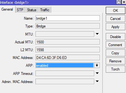

so i just disable ARP on my bride interface?
Currently is enabled
In my wan interface where i connect to VPN its enabled as PROXY ARP
You need to put your bridge on proxy arp not to disabled it !!

attached pic
Yes put this on proxy arp

that did the trick
