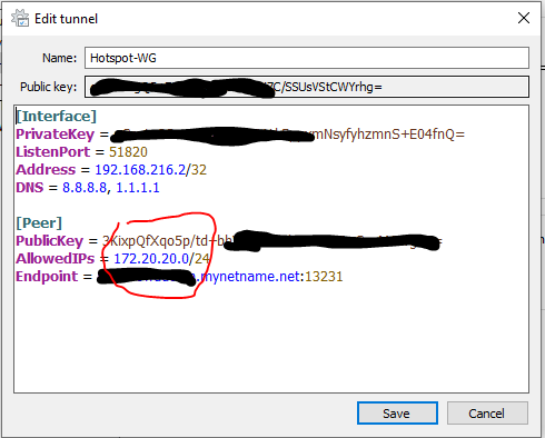

Hi Sir,
I have set my LAN network IP range to 172.20.20.0/24 in the WireGuard client settings, and I have attached an image for reference. Is this enough, or do I need any firewall filter rules to prevent leakage?

Furthermore you should also know that wireguard peers are to identify remote addresses
a. remote subnets local users need to reach
and/or
b. remote subnets requiring access to local subnets etc.
So to see any local addresses in wireguard peers is wrongo.
You have been configuring for a while now, and should know better.
You also know better than making wireguard available to the internet on the wan side a serious security mistake!!
