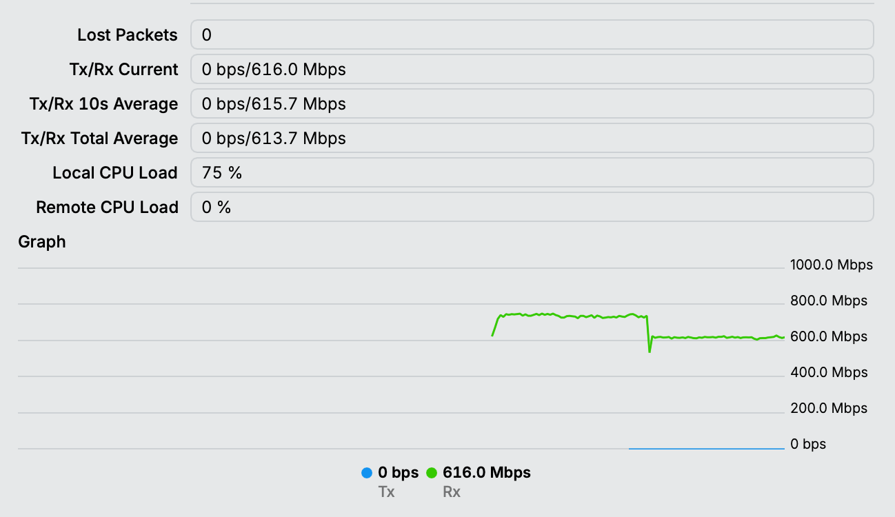

I looked into this some more and this what I got: it's about 720MBit/sec with UDP and about 600MBit/sec over TCP.
Throughput is a little higher if traffic is not routed over a GRE/EoIP tunnel but that is expected due to the lower MSS. PPPoE is also only a small difference but has noticeable CPU penalty on the RB5009.
The left part is UDP traffic, the right part is TCP traffic.
As this was never meant to be a benchmarking exercise, I did not look further into impact of firewall rules, generating traffic with iperf3 instead of the bandwidth tool. I did not max out the CPU, thus I believe that the limiting factor should not be traffic generation.
