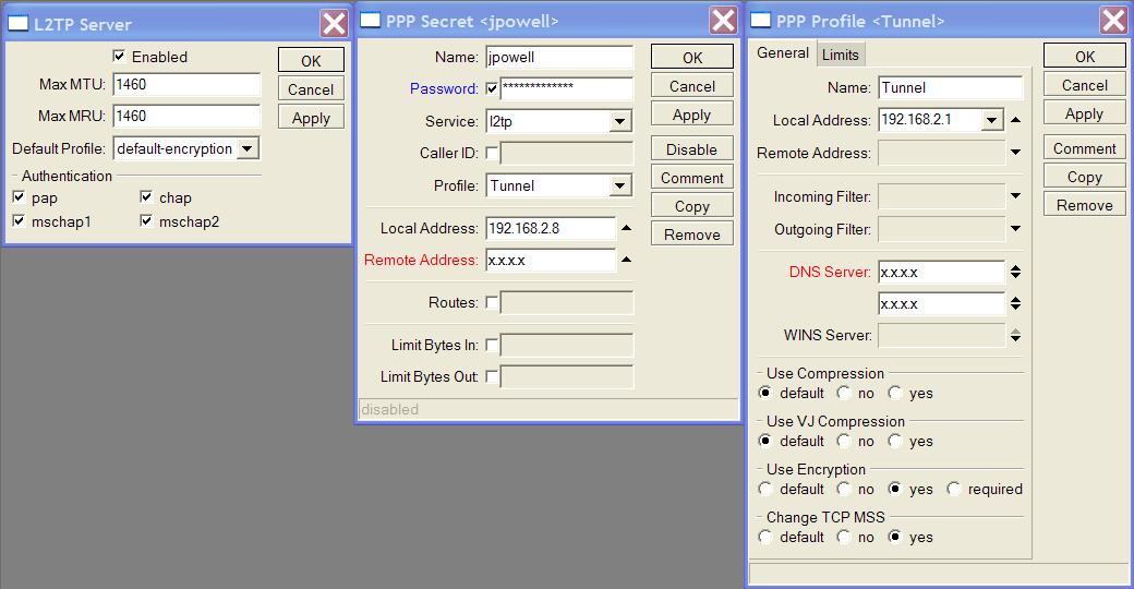

I just set up an L2TP VPN for the same purpose as you are stating. Very easy using Winbox. Just go to PPP and enable the server, then create the appropriate profile and secret used to log in. Let me know if need some screen shots.
Justin

Techsimp: I do need help with the vpn. So I enabled the ppp package, rebooted. Went to the ppp tab. Clicked L2tp server and clicked enable and then apply. Went to profiles clicked add, put in my name, and set checkboxes “use encryption” to yes, and “Change TCP MSS” to yes (did this because thats what the default encryption profile had). Then went to the secret tab and clicked add. Typed whatever name, entered a password, selected l2tp for the service, and selected my name for the profile and hit apply. I then tried to setup a standard windows dial in vpn with l2tp and it won’t connect. Do I need to add an interface under PPP or do anything specific in the windows vpn configuration properties? I also need 2 different login names and passwords. Any help would be great… thanks
from windows use PPTP, not L2TP. L2TP should work from within windows, but its a few hour pull your hair out session to figure out how to interoperate with mikrotik.

Here’s a graphic which details all the required fields to set-up a PPTP VPN.
Next we’ll tackle your routing issue.

See my config below. Public IPs are x.x.x.x
Also, I use XP to connect and had no problems on my laptop. On the other hand, the laptops at work are not able to do so (not a network limitation as my laptop works at work) but I assume it may be a configuration issue that the IT police have put into place. As I post this I see that hilton has provided a similar solution.
Justin
