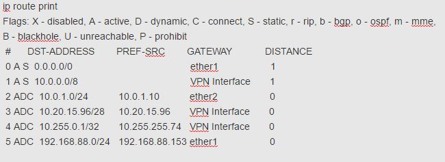

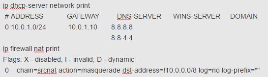

I am trying to configure a mAp2nD as an L2TP Client with port forwarding to a Raspberry Pi. The VPN connection connects just fine and the MikroTik can ping across the VPN and out to the internet as it should. When I log into the Pi I can ping the router and access the internet but I can not ping across the VPN. Traceroute from the pi stops at the router. For some reason the MikroTik does not seem to be honoring the VPN route.

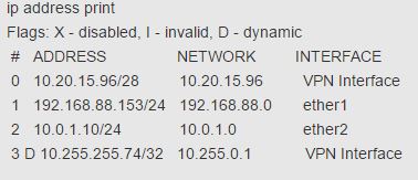

What is the raspberry IP address and why do you have static IP address on VPN interface?
The pi was given the DHCP address of 10.0.1.149. We have cameras and radios behind this MikroTik. Having everything set statically makes it easier to swap parts in and out without having to change things in our system every time. The default gateway in this instance would be 10.0.1.10 on eth2. I tried having both the VPN and 10.0.1.10 addresses on eth2 but I was not able to port forward into the cameras or pi. With the VPN interface set statically and eth2 set to 10.0.1.10 I am able to access the pi and cameras from within the VPN using port forwarding.
