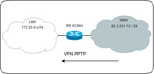

I have a problem with my VPN configuration.
I’m usung RB 433AH with ROS 3.17.
I’m trying to get access to my LAN (172.20.0.x / 24) using VPN connection.
I configured eth1 on RB with LAN address (172.20.0.250), and I added eth2 public address (83.3.251.75/29), added default route, then I configured PPTP server.
VPN connection is working correctly (I can get inside LAN), but ONLY when I’m using other public address within the same subnet (i.e. 83.3.251.76/29).
The problem is, when I’m trying to connect via VPN from internet - it doesn’t work (no connection).
Obviously I must have forgot about something, but what?? Would appreciate any suggestions.
Simple network diagram below.

It looks to me as if VPN server was ok. But the problem is somewhere at routing level.
Ok I can say that problem was solved.
mrz You were right, my default route rule was wrong.
Thank You for Your support :slight_smile:
