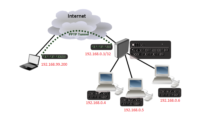

i has been done the configuration as mention to enable arp=proxy-arp, but it still cant ping to their local network device. Below is my diagram.
https://forum.mikrotik.com/download/file.php?mode=view&id=46816
