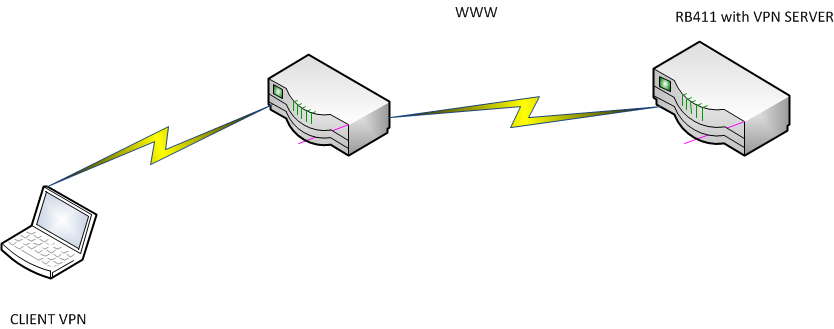

I want to setup a VPN server using one RB411 and one laptop usion Windows 7 or Mac. The laptop is conectec with another ISP. I setup the VPN server with pptp, I think the conection doesn’t work because I miss a route, It any way to get the routes dinamic in the laptop? or I have to insert the route Manual?

Thanks for your help, I put the configuration of the antena, I can get acces to the antena but no to the LAN
This is the SERVER VPN

The client I don’t have the configuration because can be in to much networks with difirents ip’s
