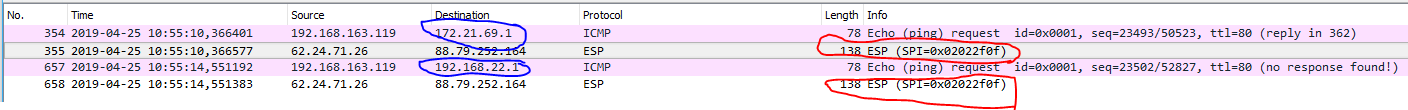

I made a sniff and mikrotik uses same policy (i see same SPI) for different subnet.
But i have defined for every subnet own policy.
here is two policies with have some collision:
7 A src-address=192.168.163.0/24 src-port=any dst-address=172.21.69.0/24 dst-port=any protocol=all action=encrypt level=uniqu>
ipsec-protocols=esp tunnel=yes sa-src-address=62.24.71.26 sa-dst-address=88.79.252.164 proposal=default ph2-count=1
18 A src-address=192.168.163.0/24 src-port=any dst-address=192.168.22.0/24 dst-port=any protocol=all action=encrypt
level=unique ipsec-protocols=esp tunnel=yes sa-src-address=62.24.71.26 sa-dst-address=88.79.252.164 proposal=default
ph2-count=1
Mikrotik uses the same SPI for both subnets and uses the SPI that is newer.
Here is sniff from mikrotik. Mikrotik uses same SPI (red marked) for addresses from different subnets ( blue marked):

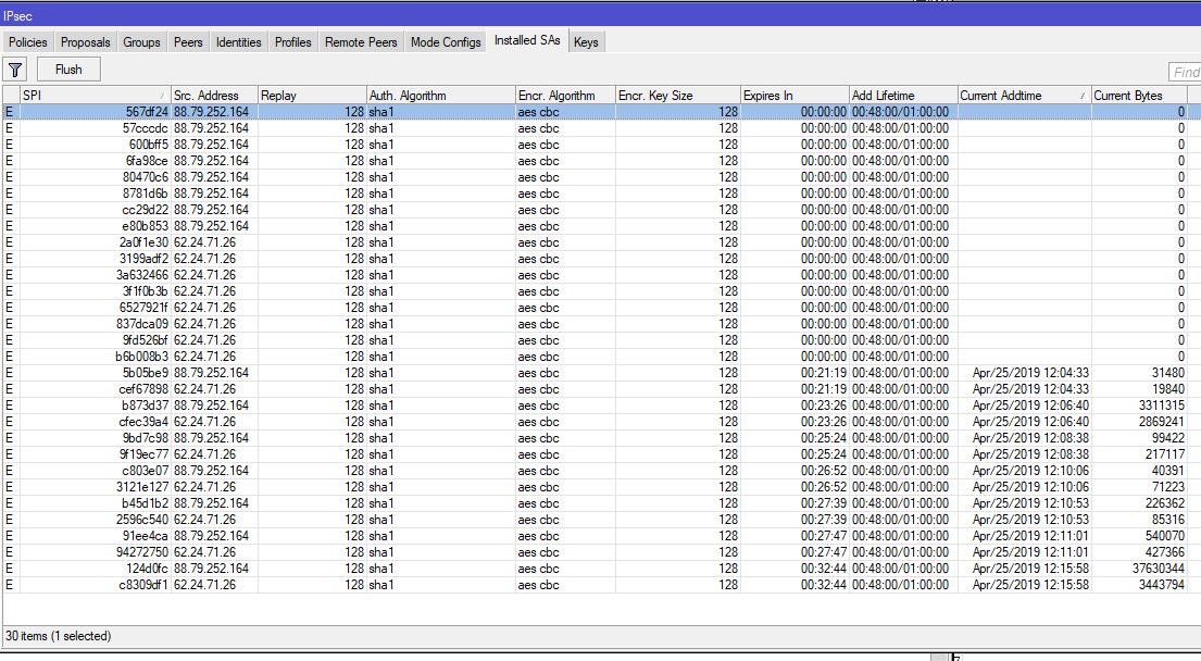

What does /ip ipsec installed-sa print where src-address~“88.*164” or dst-address~“88.*164” say? If it shows more than two established SAs, what are the SPIs of SAs in the same direction, same or different?
Normally when level=unique is used, each policy triggers establishment of its own pair of security associations (with individual SPI in each direction of course). So if you can see double the number of installed-sa towards the Sophos as is the number of policies, and nevertheless the same SPI is used to transport pings to destinations matching different policies, something is either broken in 6.44.3 or in the initial negotiation with Sophos. You should be able to see what exactly is wrong in the negotiation if you switch on logging of IPsec using /system logging add topics=ipsec,!packet, then disable the peer representing the Sophos, and then run /log print follow-only file=ipsec-log where topics~“ipsec” in one window and re-enable the peer in another window or using the GUI. After the policies become active, break the logging into file, download the file and start reading it (or post it here if you get lost).
i have 15 policies and as you can see 30 SAs. for all policies i have set Level unique.
OK, so it doesn’t seem like a misunderstanding between Sophos and Mikrotik on how to use the SAs, i.e. whether to use a single pair for all policies or not, because some SA pairs are obviously used in both directions. So the more I suspect a bug. Assuming that you cannot use the VPN anyway due to these issues, can you disable all policies for those remote subnets which work (or, even better, change their sa-dst-address to some bogus one to make Mikrotik ignore them for the Sophos peer), then disable and re-enable the Sophos peer and see whether the remaining policies work properly or the problem still persists? I mean, it can be an issue of how many policies per peer the Mikrotik stack can handle in 6.44.3 before going mad.
Here is log. What i cas see as strange is that some policies have same “reqid” eg. reqid 9. I guess this is a reason why mikrotik sends both subnet with same SA.
Do you know who is responsible for setting reqid? my side or sophos?
