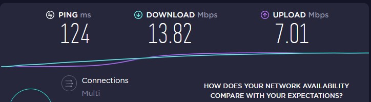

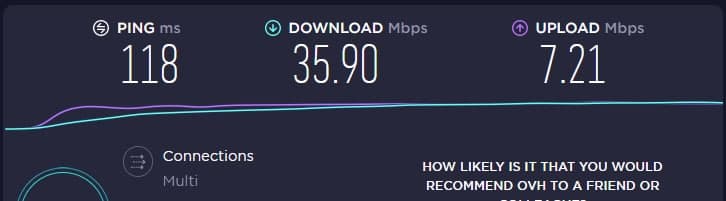

speedtest of VPN PPTP on the windows
speedtest of VPN PPTP on the router

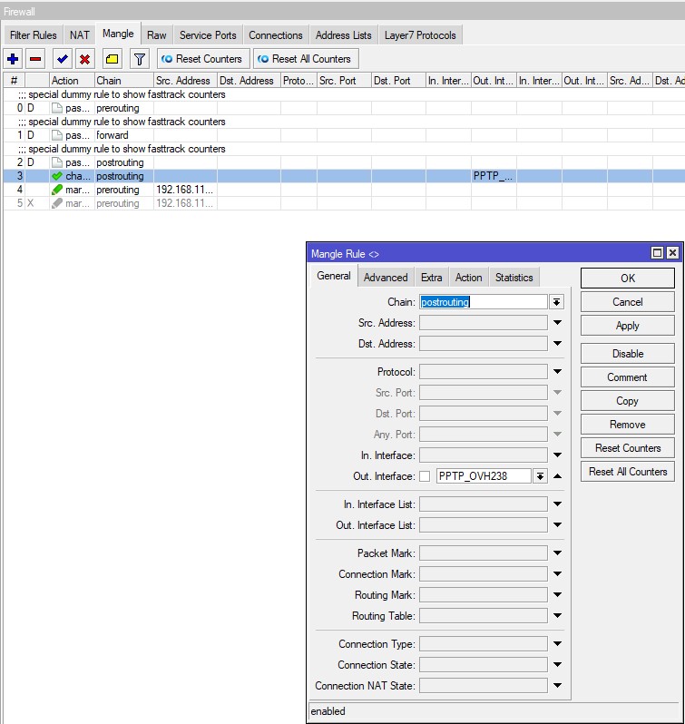

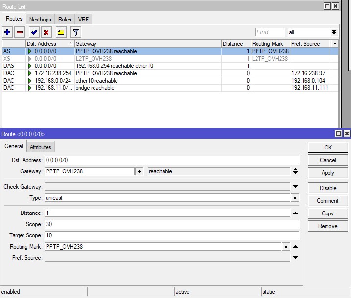

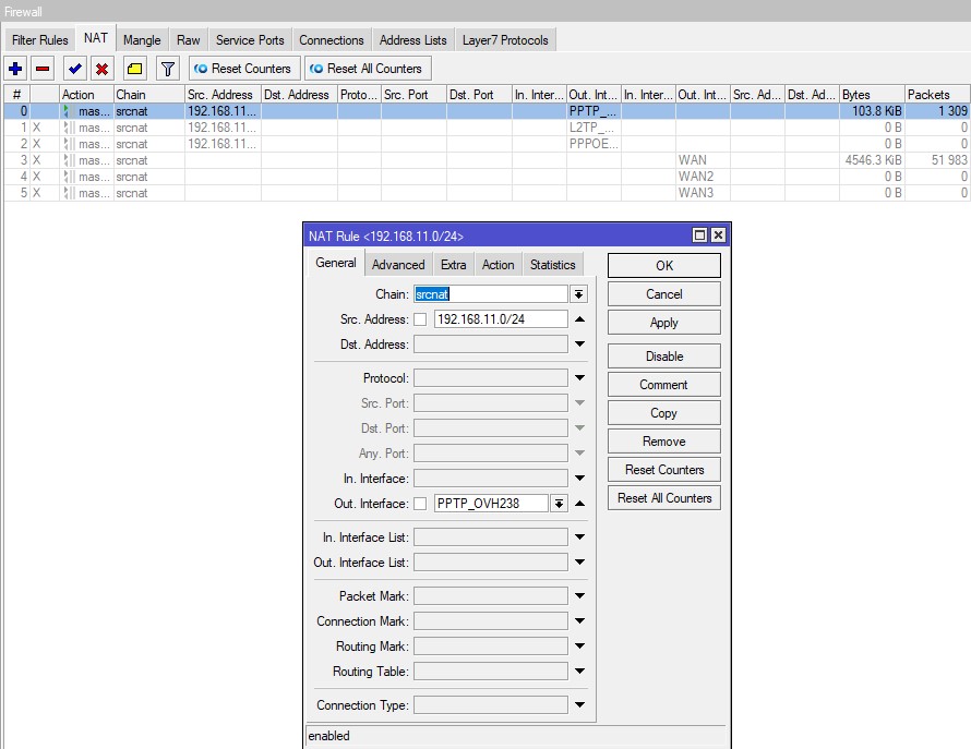

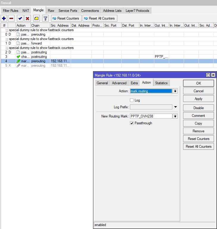

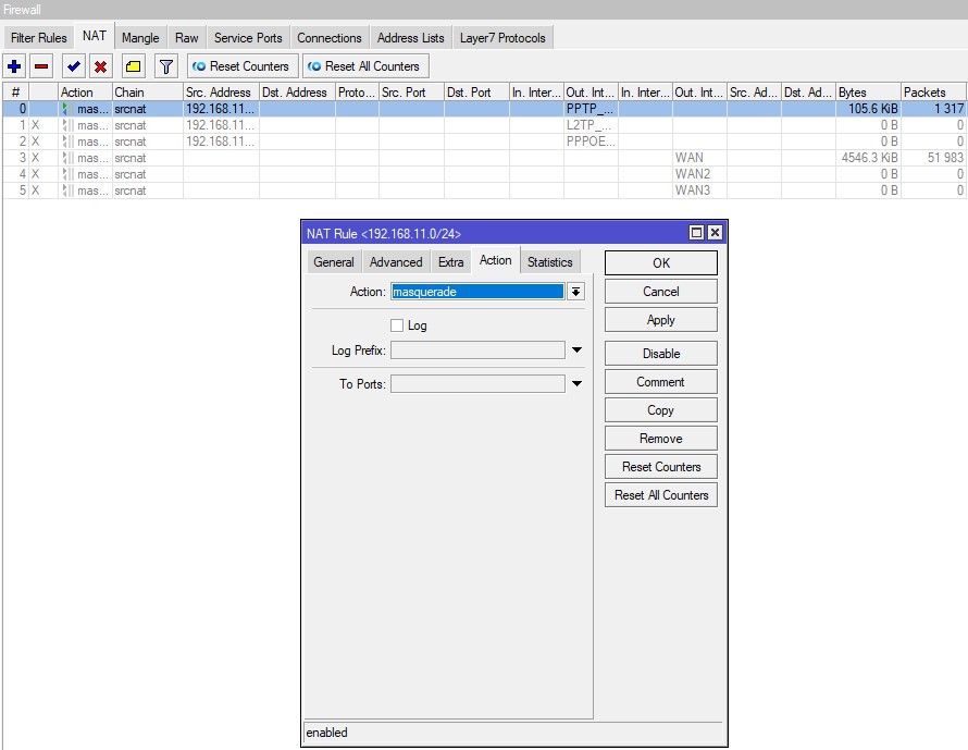

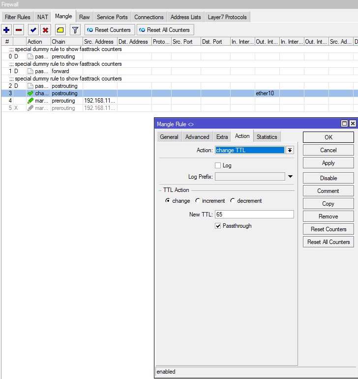

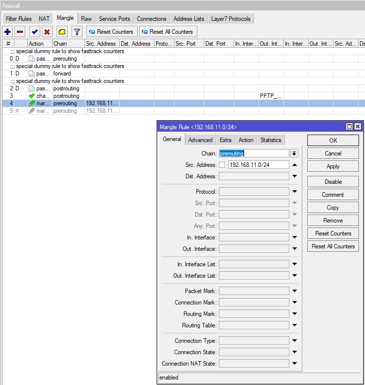

I change the TTL but no difference. I tried different numbers and test with those but all same thing, not sure my configuration is right though.

Also it’s worth mentioning that sometimes the speed with VPN on the PC or phone got also slow to about 13Mbps but without VPN it’s more than 40Mbps.
but it’s just sometimes and I’m sure it’s not about VPN server bandwidth cause it’s 10Gbps and the 1Mbps speed I got when I have the VPN on the router is not even close to 13Mbps.
Something else I notice is that in those sometimes speed down (when using VPN (no difference on the device type)) I still have full upload bandwidth (it’s 8Mbps MAX) but when I have the VPN on the router I got no upload bandwidth.

To your speed issue - the default max-mtu and max-mru settings of PPTP client interface, 1450 bytes, assume that the PPTP transport packets will be sent over an Ethernet interface with MTU of 1500 bytes. However, your WAN interface is a PPPoE one, which means a MTU of 1480 bytes or smaller, hence reducing the max-mtu and max-mru values in /interface pptp-client to 1400 might do the trick. If it doesn’t, try to add the following firewall rules:
/ip firewall mangle add chain=forward in-interface=pptp-out1 protocol=tcp tcp-flags=syn action=change-mss new-mss=1300
/ip firewall mangle add chain=forward out-interface=pptp-out1 protocol=tcp tcp-flags=syn action=change-mss new-mss=1300
With L2TP/IPsec, the issue is one step more complicated as the PPP transport packets are encapsulated into UDP rather than GRE, and the UDP ones are encapsulated into ESP, which may be encapsulated into UDP again. So even more overhead, and thus you need to reduce the max-mtu and max-mru even more to prevent fragmentation.
