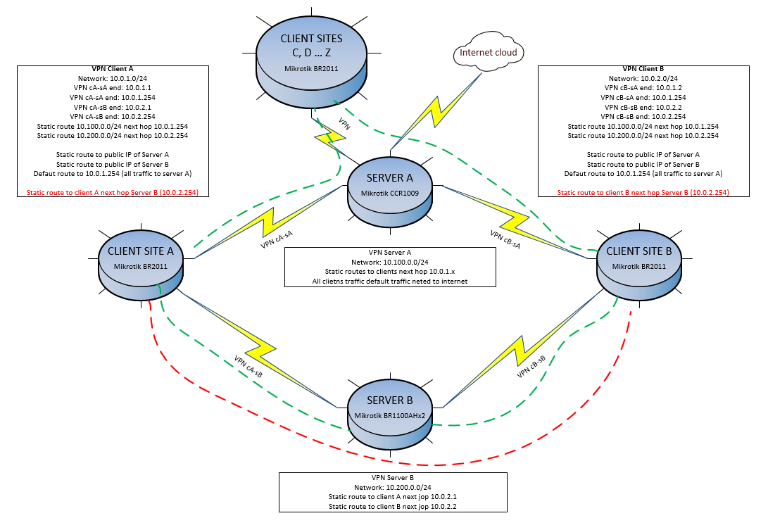

I have the same problem.
Below is my network scheme. The idea is that all traffic from all client sites pass through the main VPN server (server A).
All communication between clients is working (green routing paths).
BUT!!! From some reason, I the client’s A and B communicate each other by VPN server B. All routes on clients are configures. Client A site see server B site and vice versa. As well as client B site see server B site and vice versa. BUT client B site can’t reach client A site.
It makes me crazy.
I tried with other RB1100AHx2 - no change.
I tried with proxy-arp on all interfaces - no change.
I tried with different VPN types except IPSEC - no change.
Traffic between clients A and B always stuck on 10.0.2.254 (Server B).
