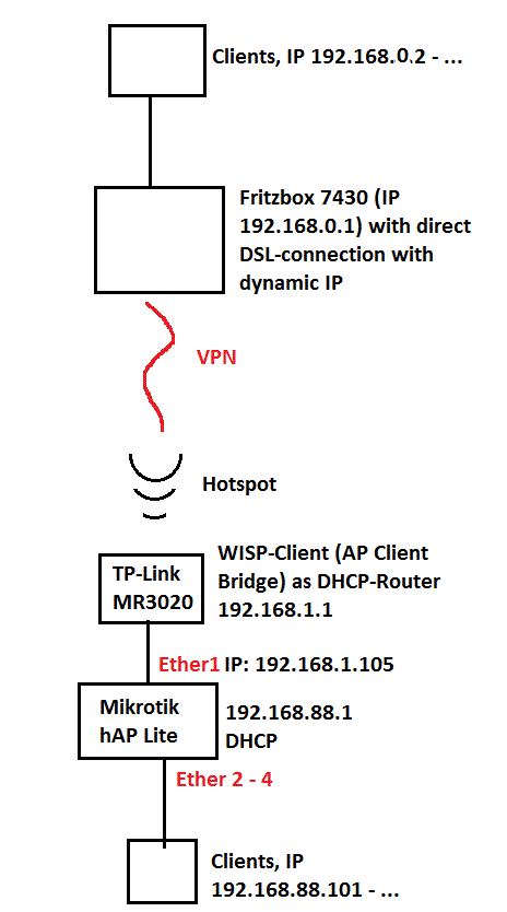

I try to setup a VPN connection with a hAPlite to my Fritzbox 7430 at home. For your info: the Fritzbox only can use IPSec. This works good for my when using my Windows 7 laptop, my Android phone or an IPad.
I got the VPN connection to work with my Miktrotik: The connection is established as I can see in my IPSec policies (PH2 state: established) and on my Fritzbox.
But there are no data going through the tunnel! I can browse the Internet with my IP I got from the uses Hotspot but I can not access any device in the home network or even ping them.
The config from my miktrotik and my Fritzbox are attached although the setup I use. I already tried to change the NAT roule in the firewall but there must be an error in my config…

All the other-than-Mikrotik IPsec clients you connect to your Fritz are individual devices, right? So they get assigned an IP address from there. The configuration of Fritz assigns 192.168.1.0/24 to the client’s subnet, which means that only packets with source addresses from this network will get to the tunnel. But according to your picture, your Mikrotik’s clients get addresses from 192.168.88.0/24.
So you have several possibilities:
  • to change Mikrotik’s LAN for clients to 192.168.1.0/24 (it needs to change dhcp pool and dhcp network accordingly)
  • to use a NAT rule to change source addresses of packets sent from 192.168.88.0/24 towards 192.168.0.0/24 (the network behind Fritz) to 192.168.1.2
  • to change the configuration of Fritz and replace 192.168.1.0/24 by 192.168.88.1 there
Also bear in mind that regardless which of the approaches above you choose, for packets not sent from Mikrotik itself but from other devices via Mikrotik, you have to shadow the srcnat rule of the default configuration which changes the source IP of all packets sent out through the internet uplink. See https://wiki.mikrotik.com/wiki/Manual:IP/IPsec#NAT_and_Fasttrack_Bypass for explanation and details.
