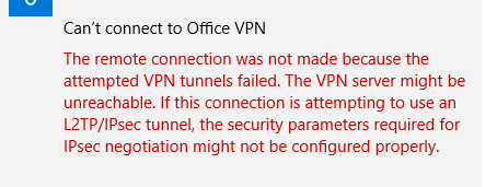

Here is another issue. I have setup a VPN for the offices outside the main subnet. It was working fine for a couple of months and now it is giving a error message,see attached.

It looks to me like a consequence of the “Windows is a service” approach, actually meaning “what worked yesterday won’t work today without warning because we know better”. So I’d first change the settings on Windows so that it would use only the particular VPN type you have configured on the server rather than trying all methods in sequence, and then I’d use the firewall rules on the VPN server (which I assume is Mikrotik since you post the question on this forum) to log whether the connection attempts actually reach the server. If they do, I’d start logging the particular VPN protocol on the Mikrotik and read the log created during the failed connection attempt. If they don’t, I’d start investigating why.

Thank you everyone that tried to help. I have figured out my problem. It was a firewall rule config that was not correct.
