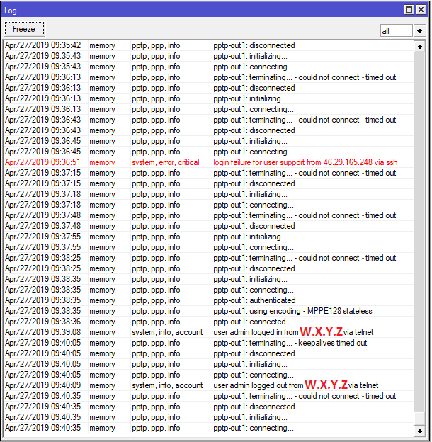

I have a problem with vpn client(mikrotik ) disconnecting from vpn server
Same issue as http://forum.mikrotik.com/t/pptp-keeps-disconnecting/48470/1
I got: terminating… keepalives timed out disconnected pptp-out1: initializing…
Mikrotik router is client and other side i have a VPN server.
The configuration used to work well until few weeks ago i got issues.
Here the configuration of the mikrotik router:
Latest firmware: 6.44.3

During the disconnection, i was able to ping the vpn server public address
Any idea where does the error come from ?
How to troubleshoot that ?
Regards
Add a route to your VPN server if you want to send all traffic there or uncheck “Add Default Route” in the client settings if you don’t.
To explain why: if your default route goes via the pptp-out1 interface, the router sends all traffic, including the PPTP transport packets, via that route every time that the interface goes up. So the interface is down, the other default route is used to set up the PPTP tunnel, the pptp-out1 interface goes up, the transport packets start being sent down that interface (so they loop into themselves and never get anywhere), so after the keepalive timeout the interface goes down, so the packets start using the other default route, the PPTP tunnel sets up and the whole cycle repeats.
By setting up an individual route to the VPN server you break the spell because the routing always chooses the route with dst-address most precisely matching the packet’s destination address.
It is theoretically possible that Mikrotik had an automagical protection against this to happen in some previous releases but I’ve seen people falling into this trap also before 6.44.3 so I’d rather assume you’ve changed something in your configuration and haven’t realized it was related.

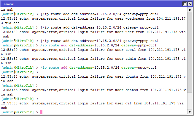

Sorry for the reply but another errors came up
Now the vpn connexion is ok (i can see the client connecting on the server side)
but now i can’t ping anything on the client side (10.15.2.0/24)
nothing is detected
same, i was able to ping 192.168.0.0/24 but now it is also impossible
i added /ip route add dst-address=10.15.2.0/24 gateway=pptp-out1
Here what i get
I check for IP: 104.211.191.173
https://db-ip.com/104.211.191.173
It’s time for disclosing your private address plan I’m afraid. If you “can’t ping anything on client side”, it means that either the ping requests do not make it to client side or the responses to them do not make it to the server side, which can be a routing problem and/or a firewall problem. So if you don’t want to draw, give a list of subnets on client side and a list of subnets on server side which need to talk to each other, and export configurations of both the server and the client following the hint in my automatic signature.
As for the unsuccessful login attempts from an address unrelated to you in your log, there’s nothing you could do about them if you have exposed your ssh service to the world on purpose. But if you did, leaving the default login name admin is a really bad idea (and even worse idea is to use PPTP, unless you have no other choice because the server doesn’t support anything more secure).

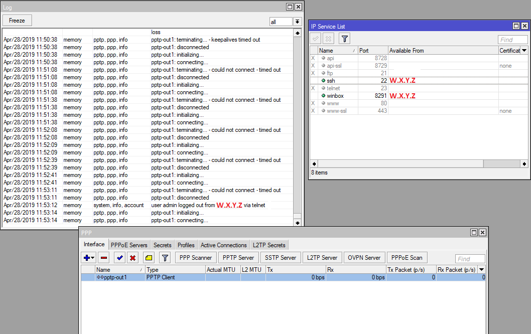

Hi
Again sorry to disturb you
I just came up with the same issue now,
II was working well all the night then the issue came up again
For security, I only enable 2 services with ip restriction
As written in my previous post, you don’t need scripting (in terms of describing your own algorithm using the script language) to get e-mail notifications about successful logins, the line /system logging add topics=system,info,account action=mailme is enough for that (provided that the /system logging action and /tool e-mail settings exist and are configured properly). You can set this up by clicking in Winbox or WebFig, i.e. you don’t need the command line for it.
Does it mean that it started failing again after you have enabled the services or these two pieces of information are not related? I.e. the two services were permitted also during the night when the PPTP tunnel was not failing?
What RouterOS version were you running on this box when you’ve allowed Winbox access from WAN side for the first time ever?
Hi
RouterOS version was maybe 6.41 or lower
If so, the first thing I’d do would be to netinstall the machine, as the probability that it has been squatted by some malware is too high. So the chance that the behaviour you observe is a consequence of some activity of that malware is high too.
