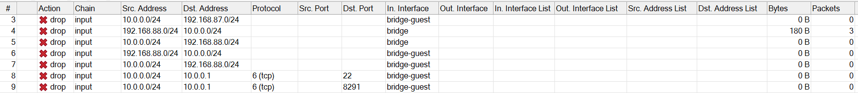

I have the following firewall rules for isolation as well as route rules. It’s very dirty and I’m not happy with it.

So in exploring this, I’ve found that the route drop rules were effectively useless.
Even though I was denying routing between subnets, traffic was still routing across those networks.
My final solution is still a mix of firewall rules and the only one route rule I found to be effective in actually dropping the specified traffic.
I opted for all interfaces because there was patchy coverage when sticking to per-interface rules, either way my end result is exactly what I want:
  1. An offending packet never makes it to the other bridge interface / traffic is dropped with no ingress to the other subnet
  2. Both bridge interfaces reach VRF main to utilise the default route but never cross-talk
  3. Each subnet has its own separate broadcast domain
I’m guessing there’s more to the MikroTik implementation of VRF that I do not understand but I will leave it at this because my intended solution works.
I’m also guessing it has something to do with route rules not applying to internal subnets and only external routes.
I’m trying to create a mental image in my head so I understand the flow but I’m still no closer to conceptually getting it.
I’ll run some more test cases at a later date and post the results if I remember to.
I hope this post helps anyone trying to achieve the same results as me get there without the frustration. :slight_smile:
The order of firewall rules, the understanding of the role of chains, and the understanding of what a stateful firewall means (to me, “state-aware” would be a more explanatory name but English is not my native language) are the key.
For your goal you don’t actually need a VRF. Drop rules after the “accept established, related to them, or excluded from connection tracking” rule prevent new connections from getting established, so if you run a ping between devices in the two subnets and then install a new drop role to the end of the filter, the traffic keeps flowing thanks to the “accept established…” rule. A new ping series will not.
And most important - chain input handles traffic towards the router itself. To handle the transit traffic, i.e. the one the router forwards from one interface to another, you have to put the filter rules to chain forward.

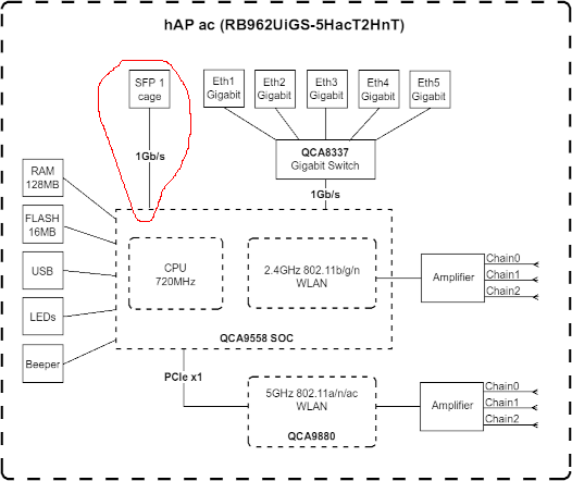

I also need to test and scale the same setup for my friend and his family so I wonder if the hAP AC can handle it (1 CPU).
Potentially 4 separate networks all with Internet access (and possibly a 5th for IoT).
The key question here is what is the uplink bandwidth. Here is a test done using 6.4x with a PPPoE uplink on a hAP ac², so with a direct IP one (static or DHCP) it should be better. The third test is the most relevant one. Blocking access between the four LANs won’t affect the performance much, but a “lot of small packets” type of traffic will lower the throughput in Mbit/s.
hAP ac (not ², not lite) has a triple-chain WiFi but a much weaker CPU than hAP ac².
Uplink bandwidth will be around 100Mbps to 220Mbps
It will be 1Gbps fibre link to SFP (hAP AC has a separate 1Gbps interface to the CPU)
So wlan1 and wlan2 (2.4GHz and 5GHz respectively) will have VAP’s on them.
Bandwidth will be shared out of the 2.4 GHz 300Mbps theoretical maximum (40MHz + 2S because I doubt there will be any 3x3 clients for 450Mbps on 2.4GHz)
and the 5GHz will let 80MHz + 3S up to 1300Mbps but realistically max for 2x2 clients is 866.6Mbps.
Of course all of this will be reduced after noise, CCI and link rate so I’m hoping for at least 70% - 80% total useable capacity
I’m not worried about the WAN link side, more the wireless side because if a client starts downloading at 800Mbps sustained, there is a CPU spike.
Yes, hAP AC2 and AC3 are better choices because of the better CPU but the dedicated SFP port on hAP AC is hard to miss for 1Gbps fibre setups.
