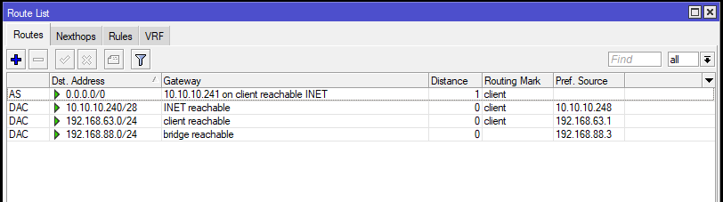

i am tesing vrf lite with wAP 60G device. I want to put the client into a “client” vrf that should not be able to access interfaces in the “main” vrf.
My routing table looks like the following:
The strange thing is, that i am able to ping 192.168.88.3 from the client net 192.168.63.0/24.
I am using the following config:

To summerize, i created a bridge “client” and and i am using the standard bridge “bridge”. I am not sure, why routerOS is routing those packages from my client 192.168.63.100 → 192.168.63.1 → 192.168.88.3. I am starting at the VRF “client” so as i understand, no route leaking should be possible?
