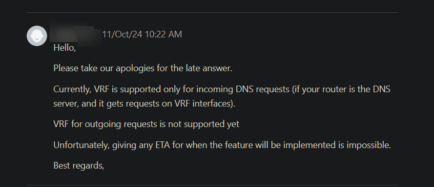

DNS is not yet fully VRF aware as i was told by MT support last year (unfortunately i cannot look back into the SUP ticket as of no tickets are shown to me in my account weirdly)
VRF setting here is more to be understand like to tell the DNS service on which VRF it will LISTEN for DNS REQs rather than making upstream requests in that VRF (which is not working up until this day)

so here is the last answer i got in SUP-160816
