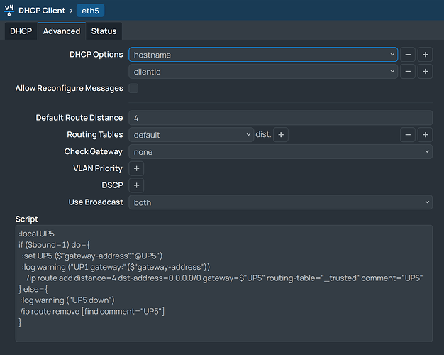

default config by first start
/ip vrf add disabled=no interfaces=eth5 name=UP5
/ip vrf add disabled=no interfaces=trusted name=_trusted
bridge “trusted” + eth4 + dhcp server
____

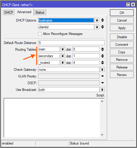

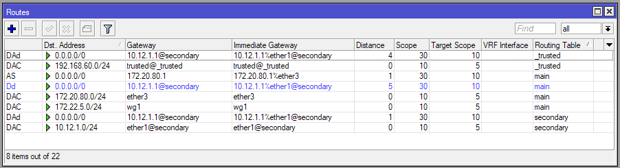

FYI, instead of the script in your screenshot, you can use this:
and the default route will also be installed correctly in the specified tables with the specified distances:
