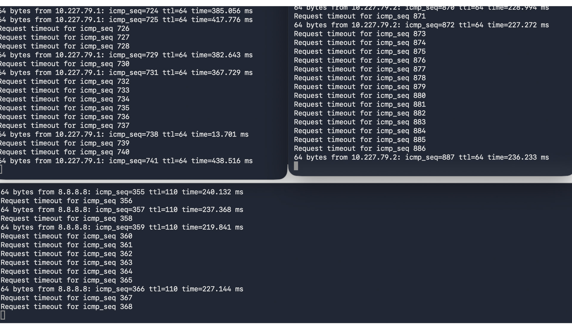

This is the screenshot of a MacOS client connected to vlan3, pinging router1 (10.227.79.1), router2 (10.227.79.2) and internet (8.8.8.8) at the time the issue occurs:
Hosts remain somewhat reachable but most of the packets are lost and if they respond, the response times are hundreds of milliseconds. Accessing either router via Winbox or SSH hangs forever and eventually times out.

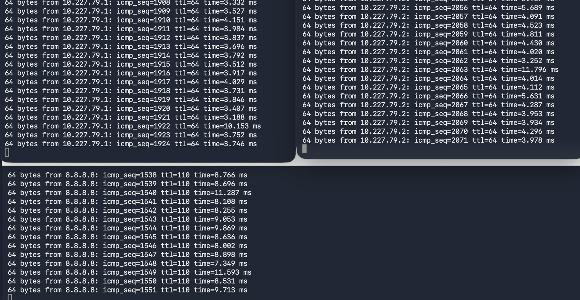

For comparison, this is before I enabled vrrp3 and everything is working:

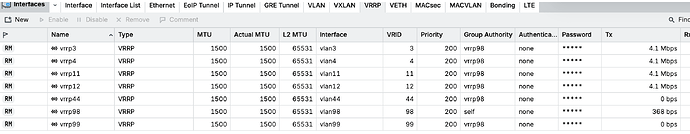

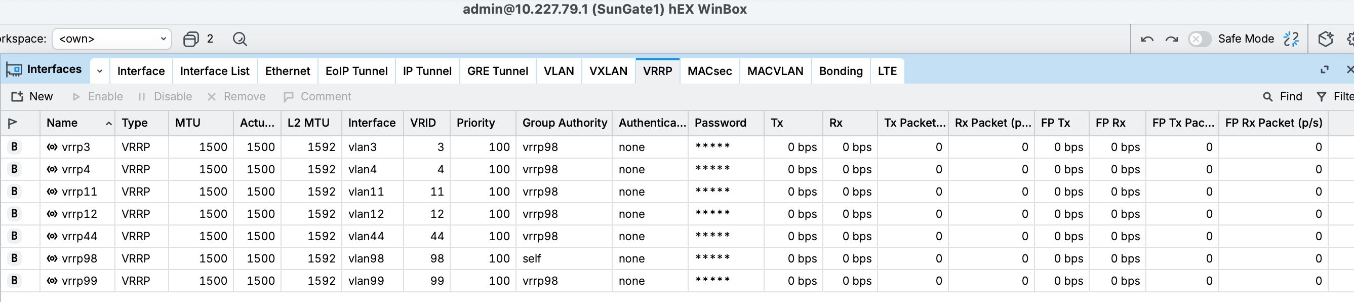

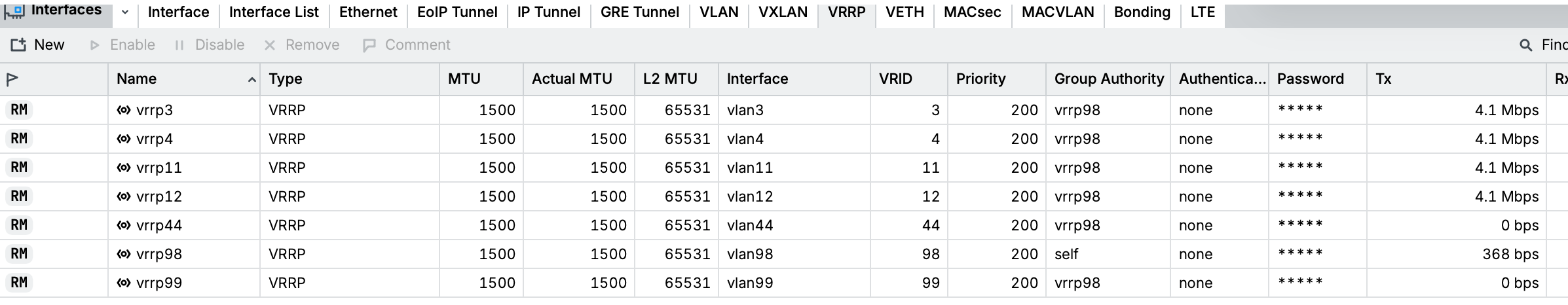

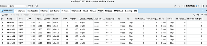

  6. Most strange: When the issue occurs, Tx of all VRRP interfaces on Router2 went pretty high, ~4Mbps. By contrast, all counters on Router1 remained zero. Screenshots:
Router2:
Router1:

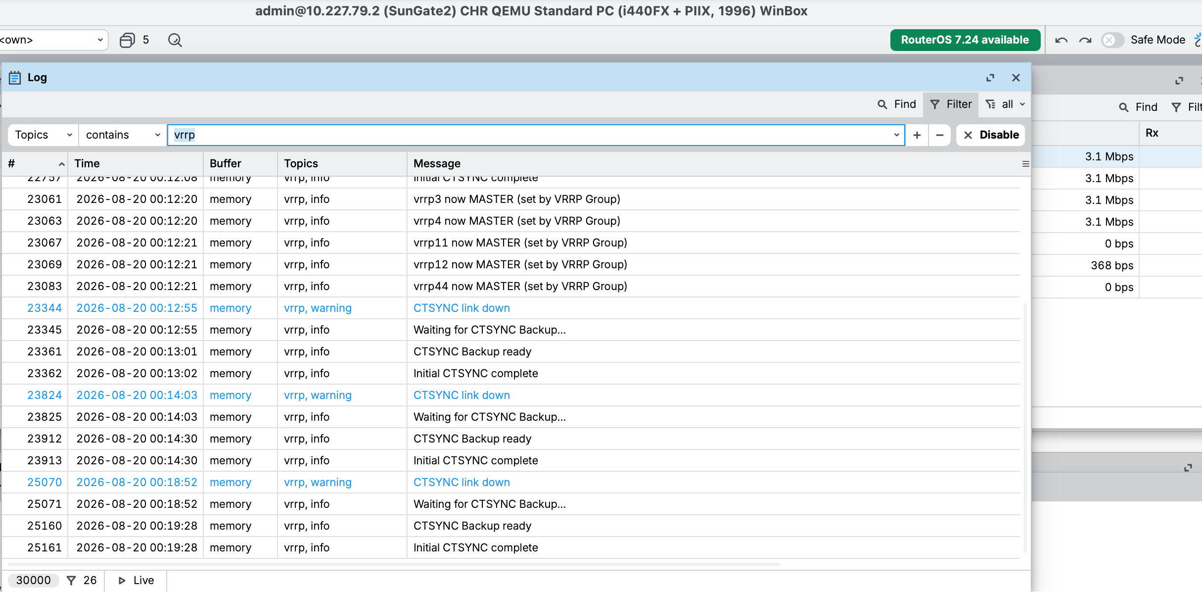

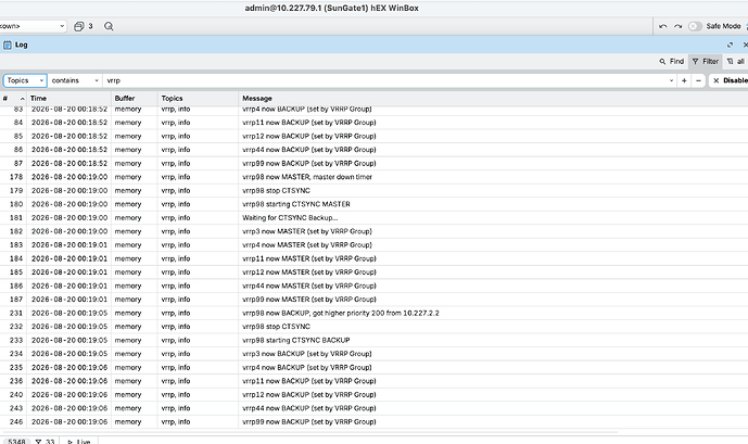

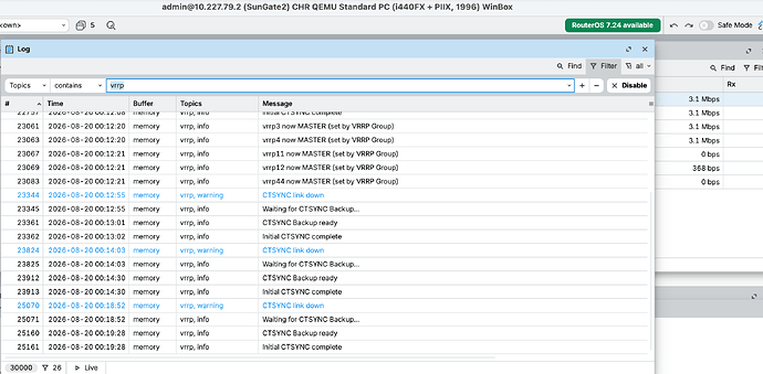

In case it's useful, log files filtered by VRRP of Router2:
And Router1:

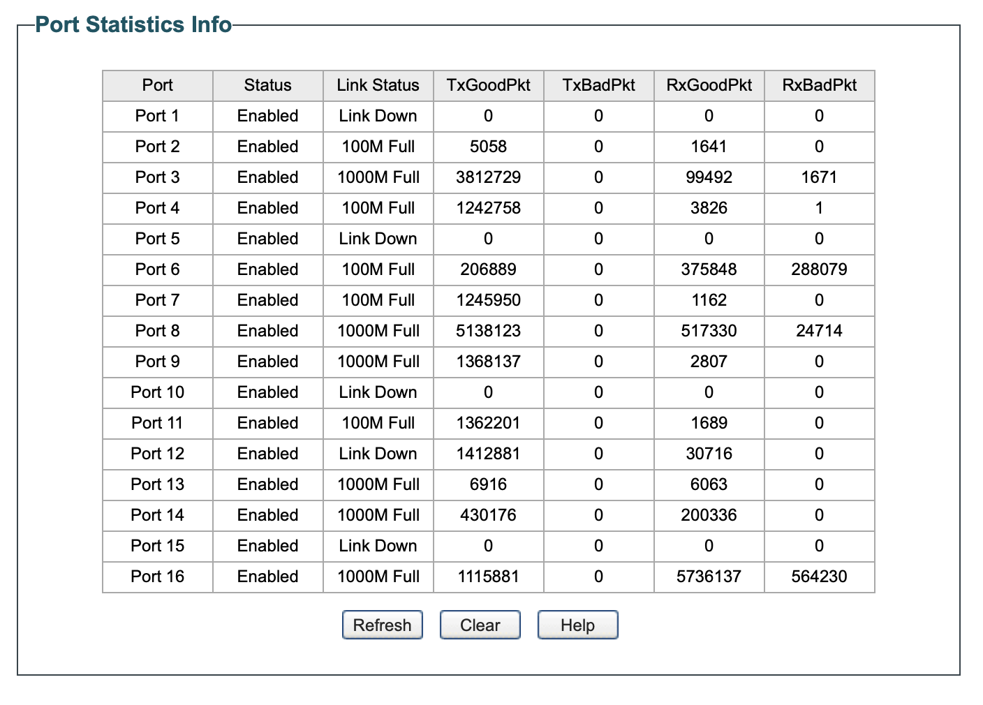

7.) Here are the port statistics of the switch:
Port 8 is hEX (Router1), Port 16 is Proxmox node (with CHR; Router2). Port 3 and 6 are wireless access points (EAP610). I am not sure if RxBadPkt are related to this issue or not but I did power cycle the switch in between and afterwards the issue occurred again.

I'd try capturing the traffic on the Proxmox physical NIC and Linux bridge while enabling vrrp3 and check bridge fdb, ip -s link/ethtool -S as well as softirq usage.
Since the TL-SG1016PE can't show the MAC/FDB table, I'd use port mirroring instead and mirror the hEX and Proxmox ports to another port, then capture the traffic with Wireshark while enabling vrrp3. That should let you see if there's a broadcast/multicast storm, duplicated frames or if the VRRP MAC address is showing up from both directions. Additionally, if you can borrow a proper managed switch that exposes the FDB table, that would be even better.
The RxBadPkt counters on port 16 are interesting, but I wouldn't draw too many conclusions from them.
