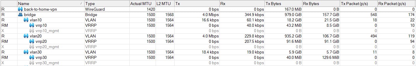

Everything I read says that in firewall filter rules, use the actual vlan interface for interface matching instead of the vrrp-interface.
However, for in-interface, it only matches if I use the vrrp interface.
I have a bridge with a few vlans. Each of those vlans contains 1 vrrp interface (vrrp is inside the vlan). Bridge → vlan → vrrp
vlan address = 192.168.1.2/24
vrrp address = 192.168.1.1/32
My laptop is on one of those vlan networks.
In the filter rules:
in-interface=vlan100 never matches.
in-interface=vrrp-vlan100 matches correctly.
Is this the expected behavior? I’m not targeting the vrrp address. I’m browsing general Internet.
So, it works, but it doesn’t match what I’m reading (although I can’t find too much).
Why is it matching the vrrp interface instead of the actual vlan interface?

Look at your interface counters, and try to understand what happens …
It’s a /32 on the router. BUT…to the PC/laptop client on the VLAN, the VRRP address is the default gateway (and appears part of the /24). VRRP responds to the ARP from PC/laptop, based on master/slave with VLAN’s MAC of active. So when the “internet traffic” would go via the default gateway, which presumably the VRRP… & thus hit the VRRP interface in firewall is to be expected. Maybe this has changed at some point, but to me it make sense you see this traffic hit the interface=*-vrrp rule.
