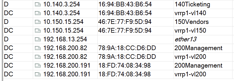

ill post router 1 which is the master.. which is pretty much identical to router 2 expect just now for testing I am using the master for dhcp. (planning on getting a CCR2004 to act as a dhcp server for the two 2116’s .
Ill post a picture of the arp devices im seeing as well..
Thank you all in advance.
Normal to see duplicate ARP entries. A disturbing rendition of a bird informs us that this is normal behaviour.
I could potentially reach 4k clients connected.. if that means I’d have double the arps would that be a problem. I google and read that Mikrotik’s limit is 8092 or something.
You only add one ARP address per VRRP interface. VRRP responds to any arp for the default gateway (aka vrrp address), so it just needs one fake MAC address per VLAN in this case. The number of users will increase ARP counts, but there still only one MAC per client even with VRRP.
Otherwise VRRP looks okay to me. The fact the VRRP interface needs to be allowed by firewall is an “easy-to-forget part”, which you have covered by an /interface/list.
I was just noticing that everything that connected was also having an arp address on the VLAN interface as well. So each device creates 2 arp entries.. what do i do when i have 5K devices lets say, and the limit for Mikrotik is 8192 (according to google) i mean i did see an option to where you could change it, just wondered if that was something i should/shouldnt do. And if i do it, in what increments would be safe to do so. It’s a (2) 2116’s so they’re pretty power routers. But still I don’t know what I don’t know.. lol
Thanks :slight_smile:
Guess this is my answer..
I should have checked myself, but you’re right it creates multiple ARP cache entries.

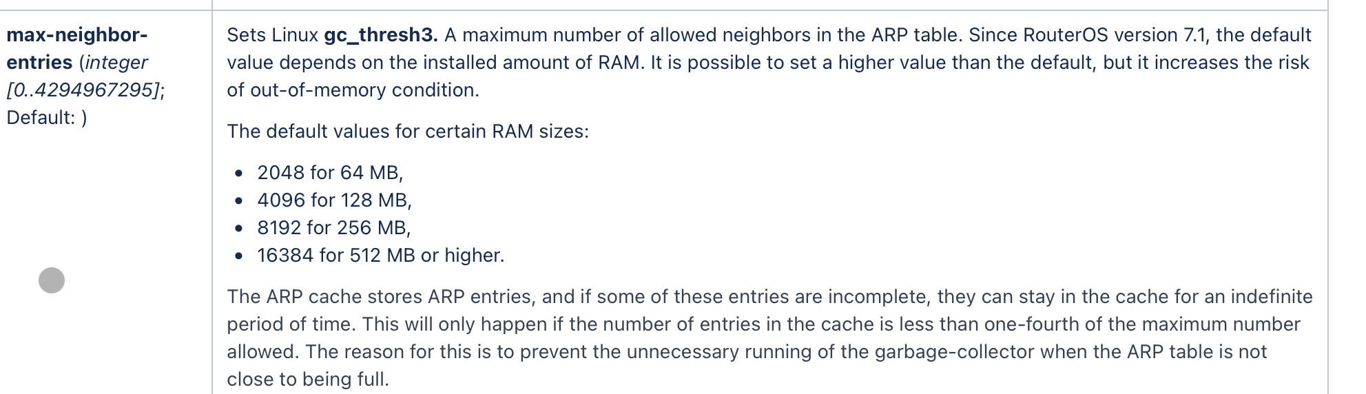

You can certainly increase the ARP cache size, which sounds like a good idea. But even if the ARP cache gets full… it’s not like things just stop working. Rather, there just more ARP requests on the network (which is less efficient, but typically not disastrous).

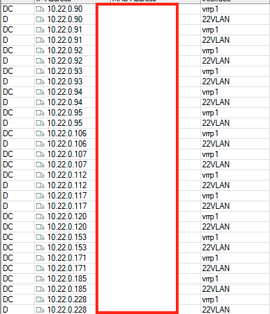

Yeah looks like that will be what happens.. this is my home router.. I dont even have 2 routers but I started the learning process here before moving it over to the (2) 2116s (and the failover works great)
But here is the arp table at home home
Side not.. my next move for these potential 4k clients is to use the smaller CCR2004 for a dhcp server.. I think it should be more than enough.. what do you think ?
If you had some monitoring, you can see if there is some meaningful effect on memory from increasing the ARP cache - but I suspect not.
In thinking about this… Perhaps the double ARPs are due to the /ip/dhcp-server. i.e. the DHCP servers for your VLANs are listening on the VLAN interfaces, so one ARP cache entry may be caused by that (other on VRRP interface be expected since that’s the default gateway).
There are few ways to handle DHCP server with multiple VRRP routers. This is where VRRP requires some decisions/complexity IMO. I typically have DHCP listen on the VRRP interface for a VLAN, on each VRRP router – so the DHCP server becomes inactive on the backup/non-active VRRP router & there is only one active DHCP server (on each VLAN) at time. Another way is just run DHCP server on “real” VLAN interface - either just one (and lose DHCP server if backup) or on both (perhaps with some delay on one of them) - not sure which one you’re using BUT it may be why you’re getting multiple ARPs.
FWIW, one more note about DHCP server with VRRP: any static lease would need to be manually sync’ed (script or cut-and-paste) as that’s not part of VRRP (not even with connection tracking).
I am running the dhcp on the vlan interface on the first VRRP router just because I wanted to test the failover.. I didnt know about delays or backup dhcp server options.. this is new to me but I can start playing with it.. also we would just trust the “conflict detection” feature.. anyone had any issues with that?
