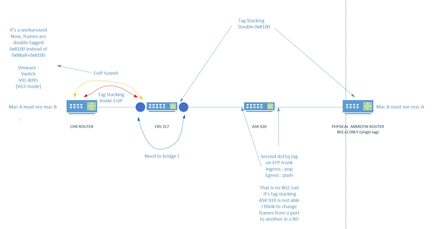

Maybe a diagram of what your trying to accomplish will help us understand what your trying to do.
Please see attachment.
Multicast is not working inside EOIP tunnel ?
IGMP Snooping on the bridge solved the problem.
Need to be verified for weeks but it works now !
