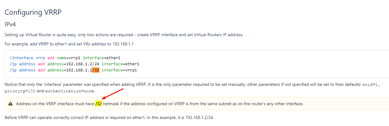

Not sure why the routes become unreachable but some pointers would help me.

I must say I cannot imagine what exactly goes wrong when you enable the VRRP interfaces, as your configuration seems fine to me from this point of view. Can you post the result of /ip/route/print in that bad state, when the VRRP interfaces are enabled?
Regardless that, I am also not sure I understand the logical topology - are the /24 subnets in the individual VLANs used solely for communication between the Mikrotik routers and the pfsenses?
Hi, thanks for taking a look. I’ve replaced the diagram on the post above with much more detail. To answer your question directly, no, the /24 subnets are used for each VLAN on both the trunk uplink and trunk links to the lower switches into the rest of the network. See below for further information.

For Mikrotik
If somebody read it from Mikrotik, I would like to ask you to change the VRRP section of the help.mikrotik.com: there is a statement in the topic that VRRP IP must have /32 netmask:
BUT if the VRRP is running on a VLAN interface, the router is not reachable with /32 netmask. I bet it is the same with any non-physical interface.
Please add some informations about that to the VRRP section of help.mikrotik.com. Thank you!
