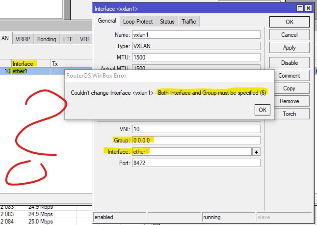

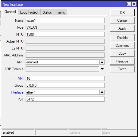

Lets do this in Winbox, default-settings, VNI set to “10” as in accordance to the manual:

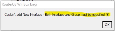

This comes out:
OK, BOTH Interface and Group must be specified… This is not what the Manual says:
group > (IPv4; Default: ) When specified, a multicast group address can be used to forward…
A “when” and “can” is not a mandatory must…
interface > (name; Default: ) Interface name used for multicast forwarding.
Who said I want that never-really-working-multicast-crap?!
MT says:
Multicast or unicast is used […]
I want Unicast, where do I specify Unicast or Multicast?

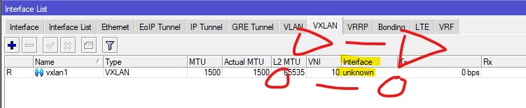

OK, the Winbox-way doesnt work :confused: lets try the CLI (as stated in the manual):
Seems to work:
or…
Lets open the VXLAN-Interface:
Now, the same happens…
Who is wrong, I, the Manual, ROS? No one, all?

as you mentioned its not possible to configure unicast in winbox, there is no specific option to define multicast vs unicast, the help does create a unicast session. When you define a vtep w/o defining a multicast group its the same as unicast.
For reference rfc7348 defines vtep as:
VXLAN Tunnel End Point. An entity that originates and/or terminates VXLAN tunnels
Using the example from help I have vxlan working unicast over a wireguard tunnel.
/interface vxlan
add name=vxlan1 port=8472 vni=10
/interface vxlan vteps
add interface=vxlan1 remote-ip=172.16.96.46
add interface=vxlan1 remote-ip=172.16.96.47
172.16.96.46 and .47 are remote mikrotik 5009’s connected back to this site via wireguard.
You cannot edit the vxlan interface from winbox after defining in CLI (seems like there is room for improvement there).
