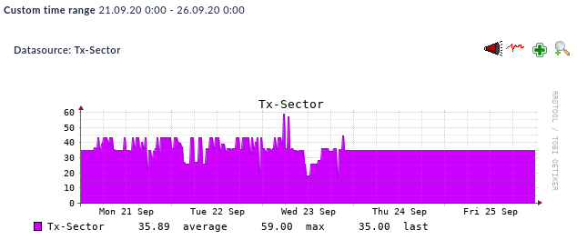

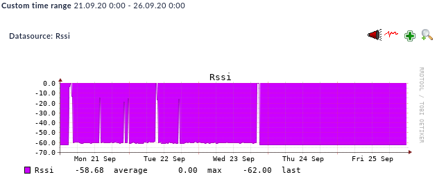

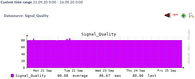

we did run into the same issues here. Some weeks ago (2020-09-21) i updated a wAP60G Link to current firmware. Afterwards i observed a lot of beamforming events (tx-sector jumping all over the place), PHY-Rate/MCS drops and serval short links loss events. Beamforming seems to be more aggressive in the newer releases.
Going back to 6.45.7 solved the issues.
Link Frequency: 60480
Link Length: 140m
Hardware: wAP60G (both sides)
I attached some plots (tx-sector, signal quality and rssi) - might be helpful to hunt down the firmware issue. Firmware downgrade to 6.45.7 was done Wednesday evening (2020-09-23). The first half of the graps shows the problem.

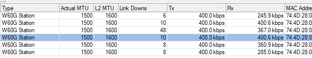

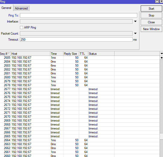

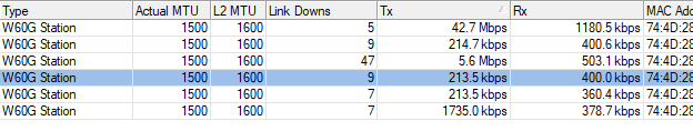

Wap 60Gx3 routerboard is pinging without any problems. Downgrade did not help. I come to the conclusion of a problem with electronics / wifi. The warranty is overdue for a month :(. When I replace the device, I will try Netinstall, but I don’t think it will solve the problem.
The problem cannot be repeated in a day. Works great.
I just don’t know what to do …
Has anyone had a similar problem?
