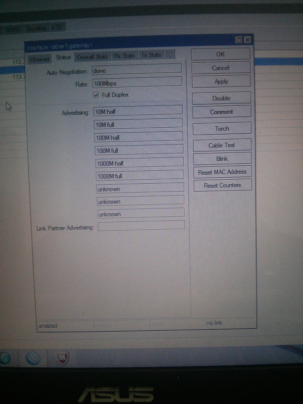

Is the link even running - in Interfaces does the ISP interface have the running (R) flag?
In the “Status” tab of the ISP ethernet port, is auto-negotiation done?

Is the link even running - in “Interfaces” does the ISP interface have the running (R) flag?

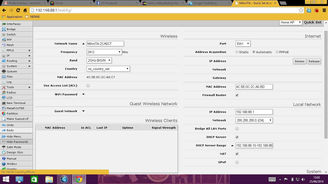

I use the default configuration (6.15) and i set by quick setup “Home AP”

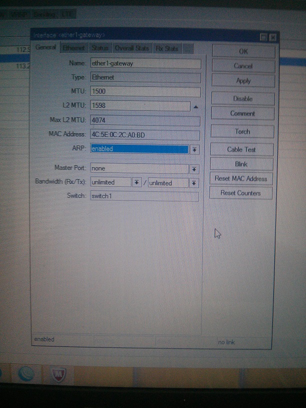

i hope that these photos explain better than my english :stuck_out_tongue:

Go into the Quick Set page but don’t change any settings. Just plug the ISP cable into port 1 and see if you get an IP from the ISP. If you don’t then post a screen shot of the Quick Set page. Also contact your ISP and verify that they are providing a dynamic IP for internet or are they using some other method to provide internet settings to you. If you are using a cable or DSL modem then do a power reboot on the ISP’s hardware.

What about showing the status tabs, not only your settings?

status screenshot (someone asked for this)
