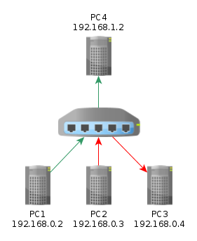

I recently bought an HAP AX^3 for my personal use at home.
I am new to Mikrotik devices, but I am not new to networks and network switches.
Few day after the initial configuration I finally found some time to do some performance testing with my new equipment, and I noticed a weird behavior:
If I have a TCP stream running between two machines in my LAN (red arrow in my graph), my upload throughput towards the Internet (green arrow) is only 200 Mb/s instead of the normal 1 Gb/s, the download speed is unaffected.
If I just send from a computer in my LAN towards the Internet using TCP, with no other significant traffic on my LAN I can saturate my 1 Gb/s connection.
If I try to stress the switch with just local traffic it can bridge 2 full-duplex TCP streams without any issues.
The problem seems to happen only when I have both local and external traffic.
In order to exclude any possible misbehavior of the NAT, I tried to replicate the setup using another port and assigning it to a different subnet. The router shows the same behavior, as soon as there is bridged and routed traffic the upload of the routed stream (green arrow) is limited to 200 Mb/s.
If I disable the HW offloading of L2 traffic the problem goes away, so this seems to be related to the HW offloading in the switch ASIC.
This is the configuration I am currently running:

Am I missing something in the configuration or there is a problem with the HW offloading?
Thank you.
I post an update.
Since the 06/03/23 the official documentation as been updated, and and this sentence has been added.
Currently, HW offloaded bridge support for the IPQ-PPE switch chip is still a work in progress. We recommend using, the default, non-HW offloaded bridge (enabled RSTP).
I guess that they are working on it. In any case it is a bit sad to release a product before it is ready, especially because there is no mention of this in the product page and I purchased it before update of the documentation.
I hope the will fix it soon.
