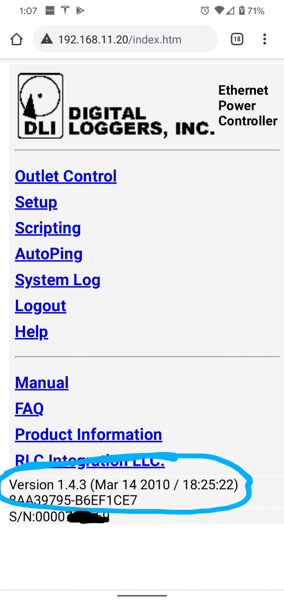

But I buy their units by the case. I have hundreds out there quietly rebooting locked up modems without me having to hear about it. I will log into a project I have not heard a peep out of in 2 years…
Will check the log on the digital Loggers and see that it seems to have to reboot the modem for cause about once every 3 weeks.
Did the customer have noticable downtime? Nope
Did they call me bitching? Nope
Did they have to try to figure out what plug to pull with a “restaurant full of people”? Nope
For years I would spend the day after a thunderstorm, on the phone explaining to people how to unplug a modem and wait 60 seconds. Then plug it back in. Enormous waste of unbillable time.
These things have saved me countless tickets.

This is also why I hate Wattbox!
They came out later.
Cost more.
And had a 100% failure rate in several revs.
Meanwhile… The DLI in my basement used to reboot a locked up modem. Now it works on my FiOS ont.
It’s been quietly doing it’s thing for a long time.
