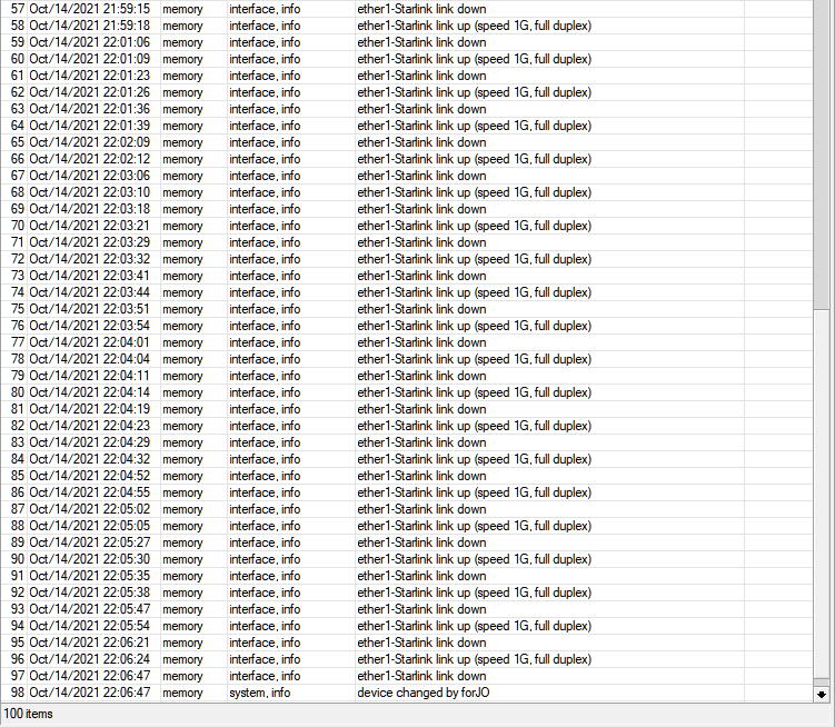

WAN Port Flapping? (w/Starlink)
used to have a WISP. Upgraded to starlink. For the first 30 minutes… starlink works great.
After about 1/2 an hour people start to notice sites not loading.
I asked the tech to check the log and got back this.
Going to have him update router OS to most current.
I did ask him to put another switch inbetween the starlink and the Mikrotik. Awaiting a call back on how that went.
Note: I had seen a port on a Mikrotik do this when I plugged some game systems right into the Mikrotik. Putting a switch in between always fixes the problem. But this is the first time I have seen it on the WAN port. And It doesn’t start the instant its connected.

06:03:42 interface,info ether1-Starlink link up (speed 1G, full duplex)
06:03:47 dhcp,info dhcp-client on ether1-Starlink got IP address 100.72.93.109
06:11:09 interface,info ether1-Starlink link down
06:11:12 interface,info ether1-Starlink link up (speed 1G, full duplex)
06:13:45 interface,info ether1-Starlink link down
06:13:48 interface,info ether1-Starlink link up (speed 1G, full duplex)
06:14:16 interface,info ether1-Starlink link down
06:14:19 interface,info ether1-Starlink link up (speed 1G, full duplex)
06:14:29 interface,info ether1-Starlink link down
06:14:32 interface,info ether1-Starlink link up (speed 1G, full duplex)
06:14:43 interface,info ether1-Starlink link down
06:14:49 interface,info ether1-Starlink link up (speed 1G, full duplex)
06:15:20 interface,info ether1-Starlink link down
06:15:27 interface,info ether1-Starlink link up (speed 1G, full duplex)
06:15:31 system,info,account user admin logged in from 108.51.70.251 via telnet
06:15:32 interface,info ether1-Starlink link down
Tried a few things and noticed the first drop out occurred at 2 minutes and 30 seconds after acquiring the DHCP-Lease from Starlink.
Sat and watched the route going up and down.
Watched the interface showing up and down.
Watched the DHCP-Clietn going between bound and not.
Set the Port Speed on the router to 100M.
Disabled interface.
Enabled interface.
Mikrotik got IP from Starlink with a lease expires time of 5 mins.
Sat and watched and at 2:30… the number jumped right back to 5:01.
I have watched this for the last 15 minutes and you can set a clock by it.
But more importantly… Starlink has not dropped out.
Turned on logging for DHCP… would you look at that…
(dhcp-lease expires 00:02:30)

Confirm that the only difference was locking the interface to 100Mb/s rather than allowing it to go to 1Gb/s?
Speculation would be a cable issue. Remember that GigE uses all four pairs whereas 100Mb/s uses only two pairs.
5 minutes is a fairly short DHCP lease time, but it looks like it is behaving normally.
It linked at Gig. And would work… For 30 mins or 2.5 Minutes then drop out every 3 seconds.
The change to 100M has not shown a disconnect state since.
Does starlink say poor ethernet connection?
Nope
Have you tried moving the WAN to a different ethernet port? I moved a port flapping gaming console to a different LAN port and it stopped flapping.
For the next test we are moving the starlink to a whole new router. It’s now connected to a 3011.
Awaiting feedback from the person onsite.
