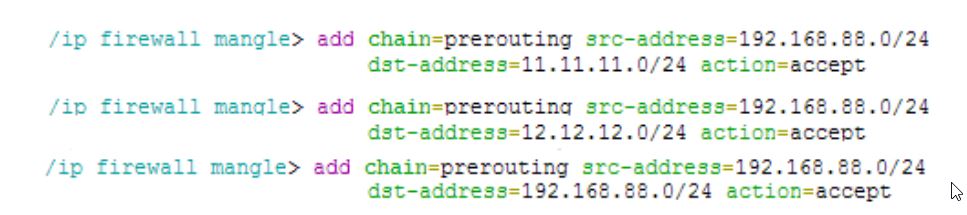

I fixed the problem.
NAT Configuration is OK, the problem is on the Mangle.
Is Necessary to configure the MANGLE like in the picture:
11.11.11.0/24 → WAN1
12.12.12.0/24 → WAN2
192.168.88.0/24 → Local LAN
I guess you don’t really know what that rule does…
You use those accept rules in the mangle facility in order to exclude the directly connected routers from your mangles…Otherwise when you try to ping lets say 11.11.11.1 or 12.12.12.1 they will be routed through your wan interfaces.. This means you will never reach them…Thus we use the main routing table for those addresses…
However you said you cant reach your Public IP.. Strictly speaking your Public IP is neither 11.11.11.1 or 12.12.12.1… Since you are behind a router and you use no tunnels, the public IPs are on your ISPs routers…
The ip on the screen are an example!!!
So you did put your real public addresses, that may not even be Static, inside your mangle rules? :laughing:
I Never, never, in all the networks i ve setup, i had to do this configuration… But anyways if it works what can i say…!
