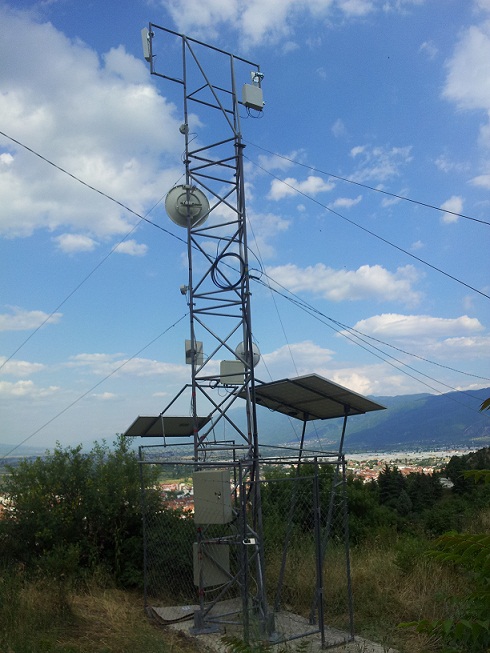

This is my tower I use 3x200W solar and 2x220Ah batteries only for equipment that consume 24V 1.1A running for 6 mounts and still testing
winter is coming and day time is getting little shorter and shorter until 21 of December and still not sure if this setup will work
