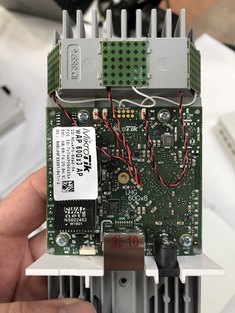

This thing looks great from the inside. I’m just guessing, but the photos i was able to take in Vienna tell some story. now here’s my theory: It is very likely this box is built around QCA6335 baseband, which has support 8 (!) phased array antennas. if you look closely, you can see the unpopulated power headers for the QCA6310 (most probably, i was never brave enough to pry the small squares out from their beds) RF stages - the red/black wires, 4 on the top, 4 on the bottom left side. the RF connectors are on the backside, and most probably only 3 of them are populated with the appropriate RF connector.
also, the silkscreen says 60Gx8 which is quite a hint that supports my theory.

Also “CH0 5G” - 5GHz backup, unpopulated again

as it has 3 separate RF stages (each one with qca6310) for the 60+60+60=180 degree coverage, this was expected.
