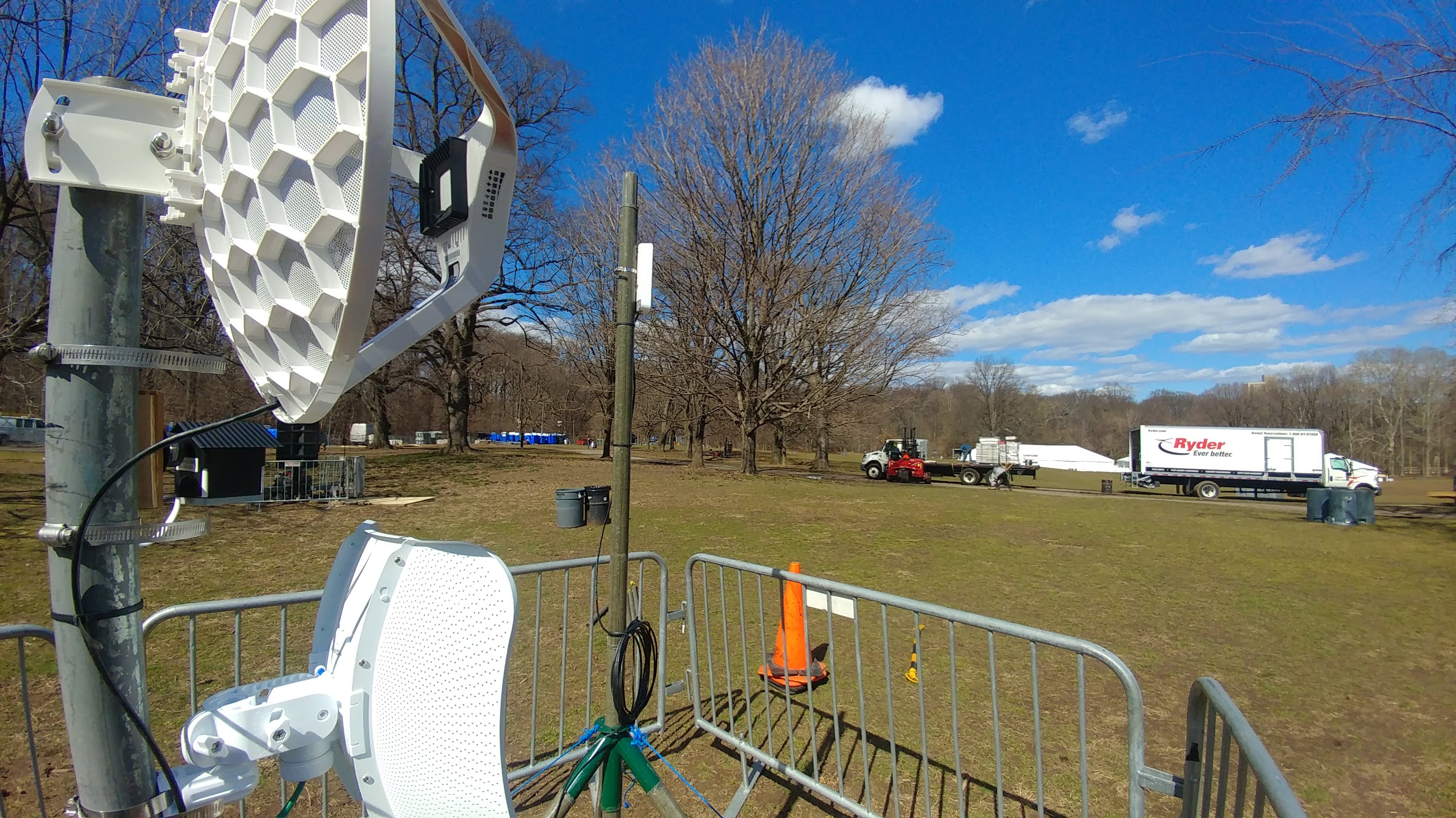

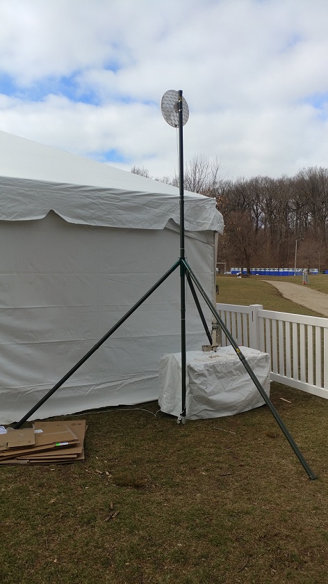

We setup a wAP 60Gx3 PMP network in Prospect Park the other day for the NYC Half Marathon with 3 stations. Overall, it worked out but the setup was slightly frustrating.
We found the alignment process to be just as difficult or worse than the LHG 60G. There seems to be a mismatch in RSSI on the station vs the sector. Even if you get -55 on the station, the sector only reports -70 or so. However, these numbers jump around too much to know what you really have.
Additionally, you can get one station connected with stable MCS 8 modulation, then go to bring another station online and now the 1st station no longer keeps MCS 8. We had a great connection for video to the Jumbotron, but then bringing up the starting line caused the video at the Jumbotron to start breaking up & cutting out. Very annoying.

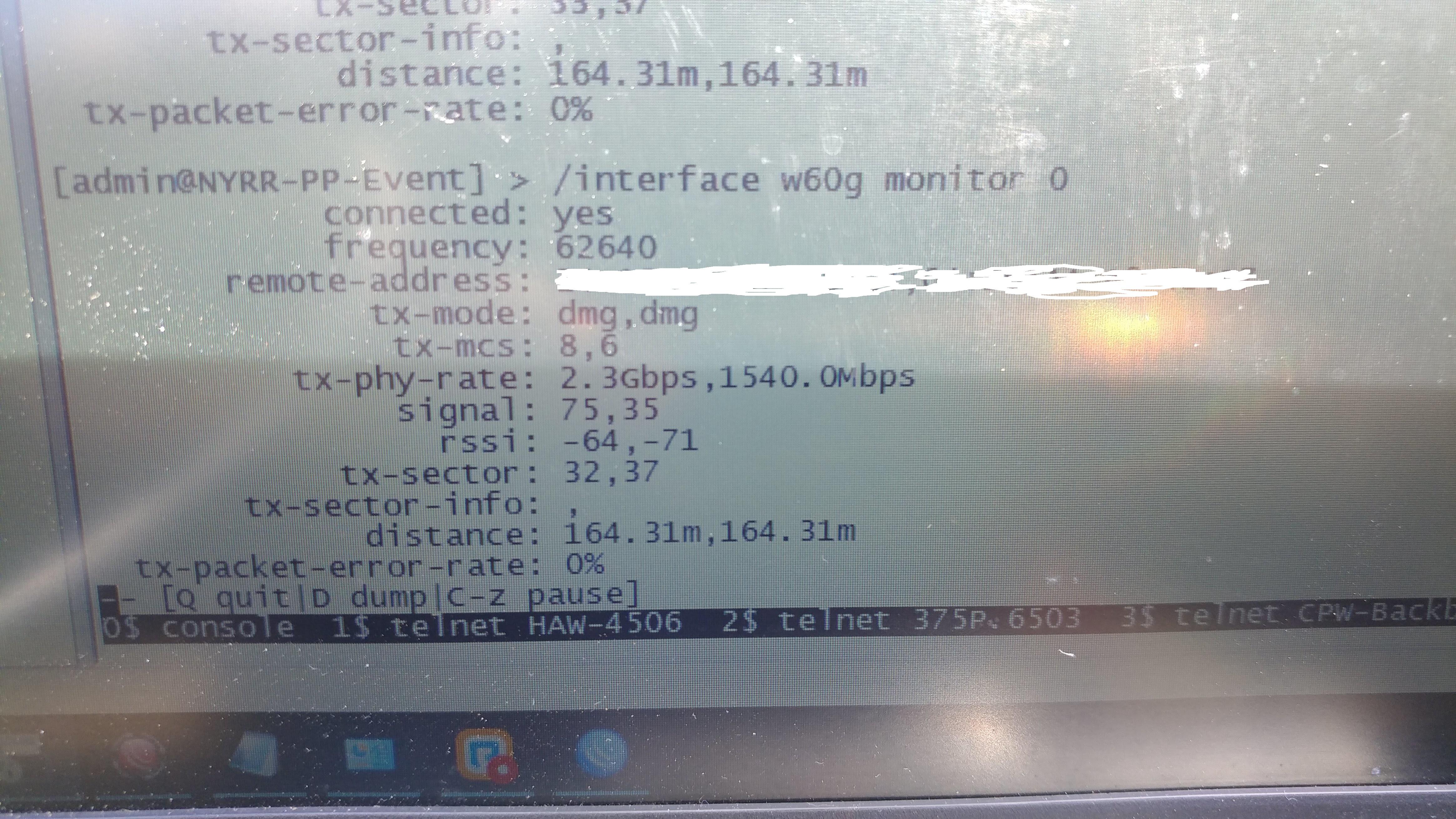

Some other minor issues like the “Distance” in /interface w60 monitor would show from the wrong station. The correct distances for 2 stations were 164.36m & 149.83m. But at the end of the day, the sector started reporting 164.36 & 164.36m. Nothing moved, and obviously they can’t be the exact same distance so there must be some software glitch when it reconnects. Not too big a deal though.
After all the links were setup, it performed well but I don’t think we would this PMP for an event again until the software becomes more stable.
