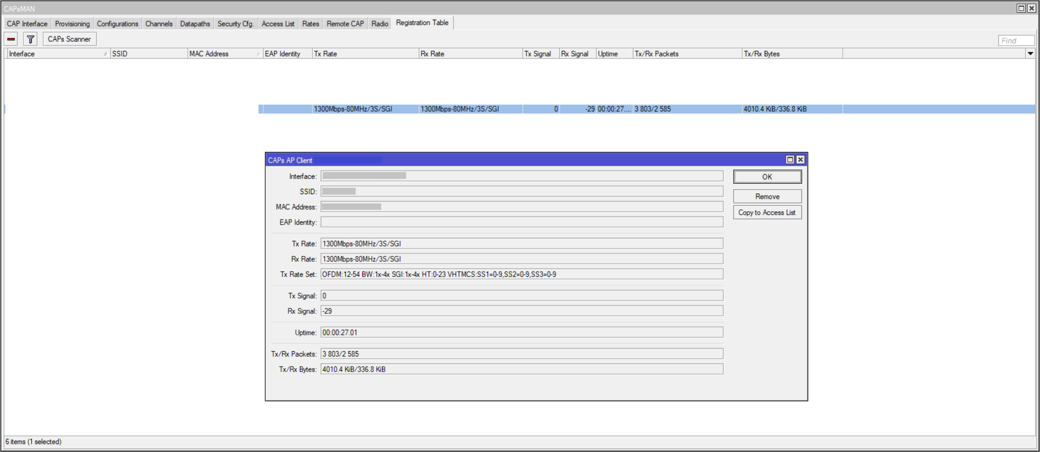

I have a large network deployed with lots of hAP AC2 with CAPsMAN and I have no such problems!
https://i.postimg.cc/3RF708fz/ccr-7.png

Here as well.
CAP AC can use 80Mhz 2S for RX but for some reason, it could only use 80Mhz 1S for TX.
Using 6.44.3.
