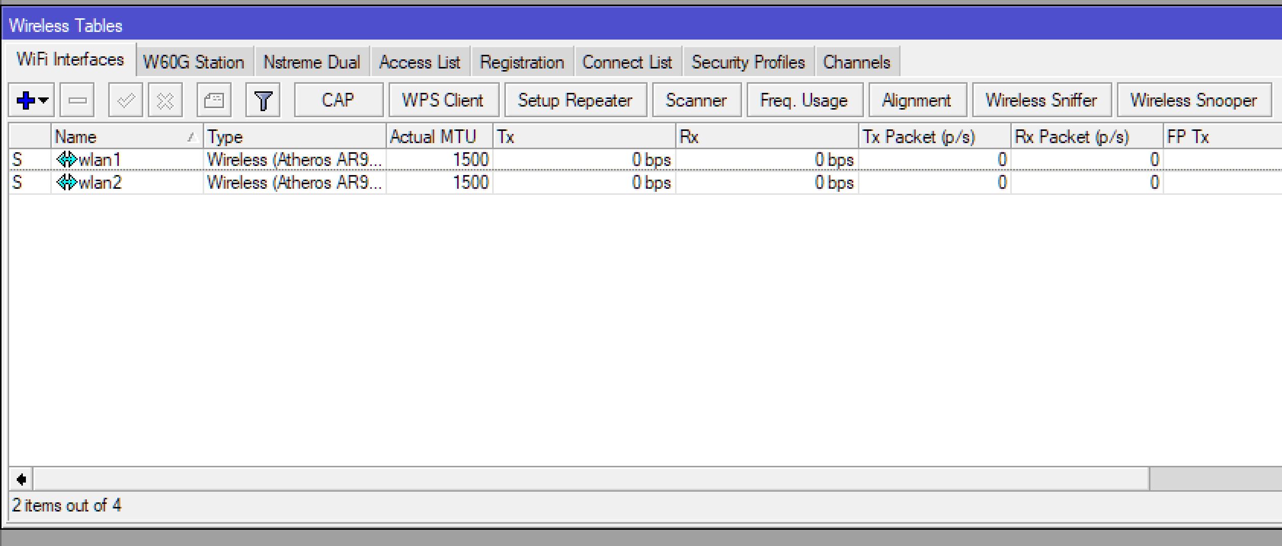

Under ‘Wireless | Wifi Interfaces’, I have set SSIDs for wlan1 and wlan2.

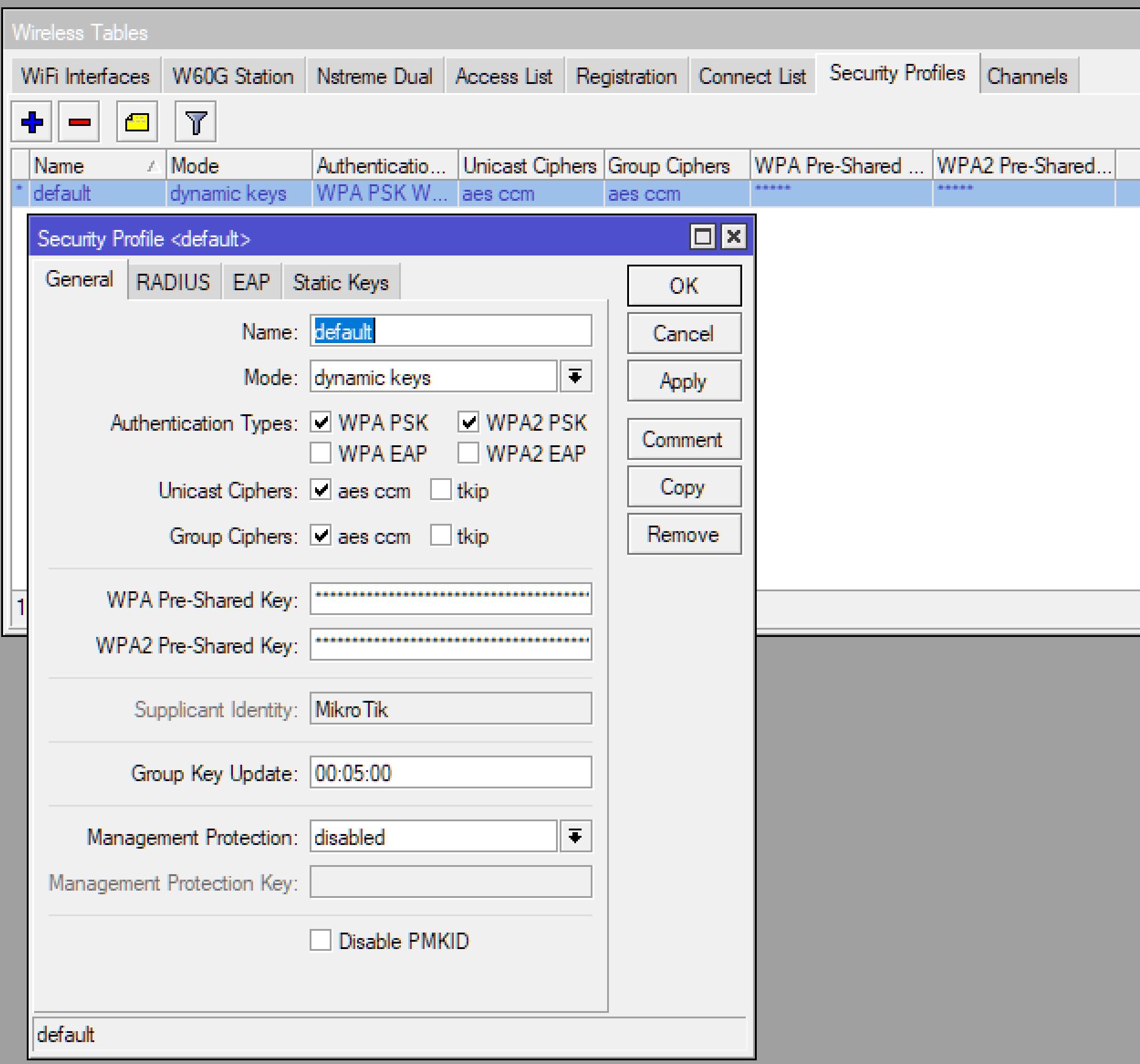

And, under ‘Wireless | Security Profiles’, I have set authentication types and preshared key(s).
At this moment, I expected the wlans to show among the available networks. But no. They don’t.
I have attached the relevant screenshots.

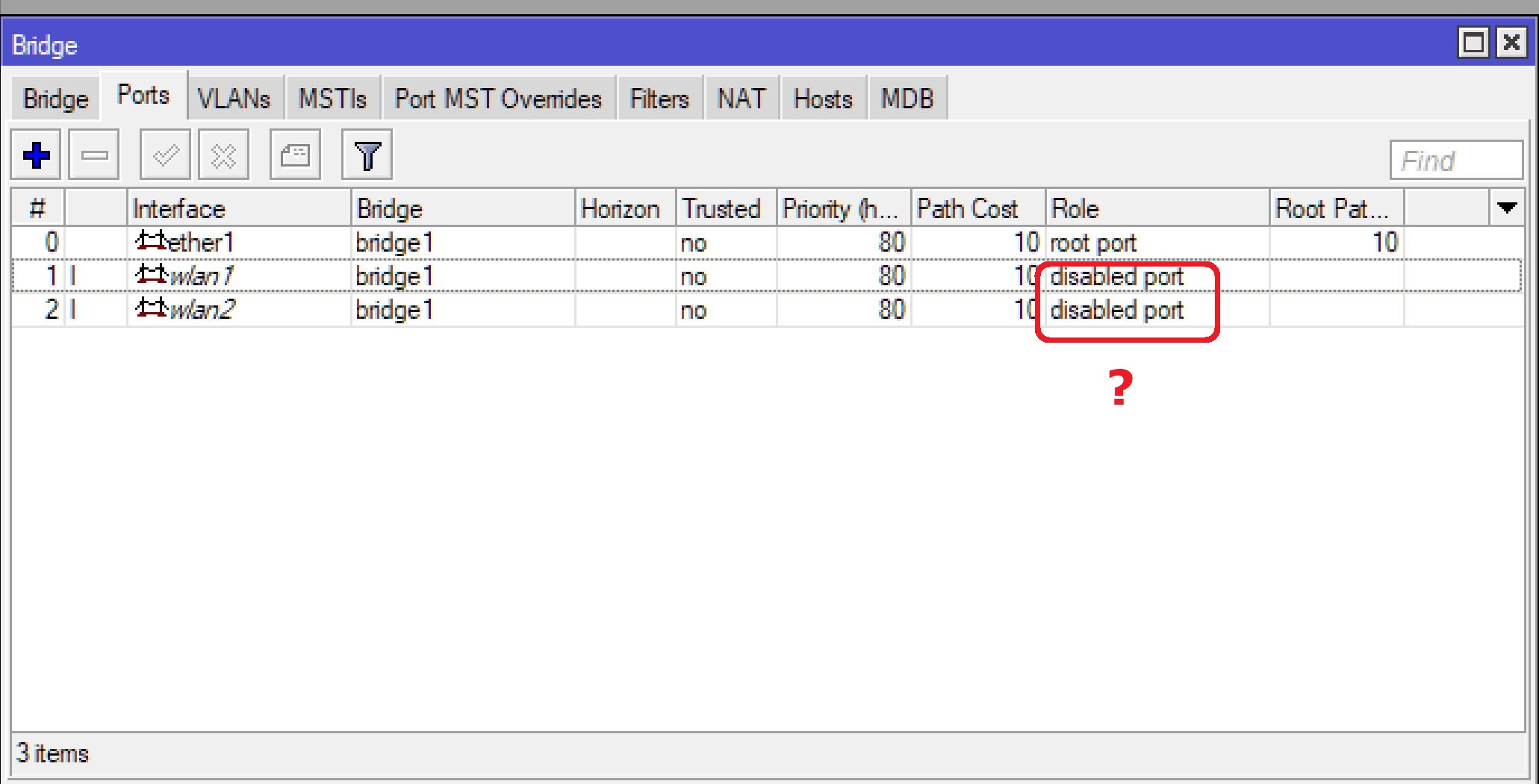

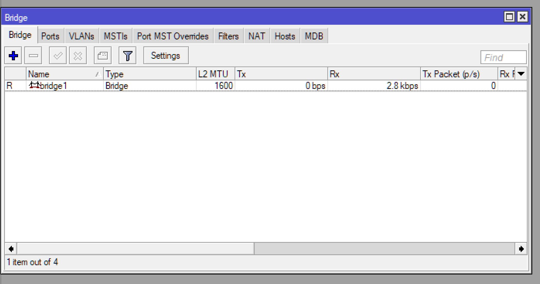

The that looks suspicious to me is this:
BTW, I apologize for dumping all these screenshots here, but I am getting frustrated; hoping they are of use to help me sort this out.
Should wlans really be 'disabled port’s?

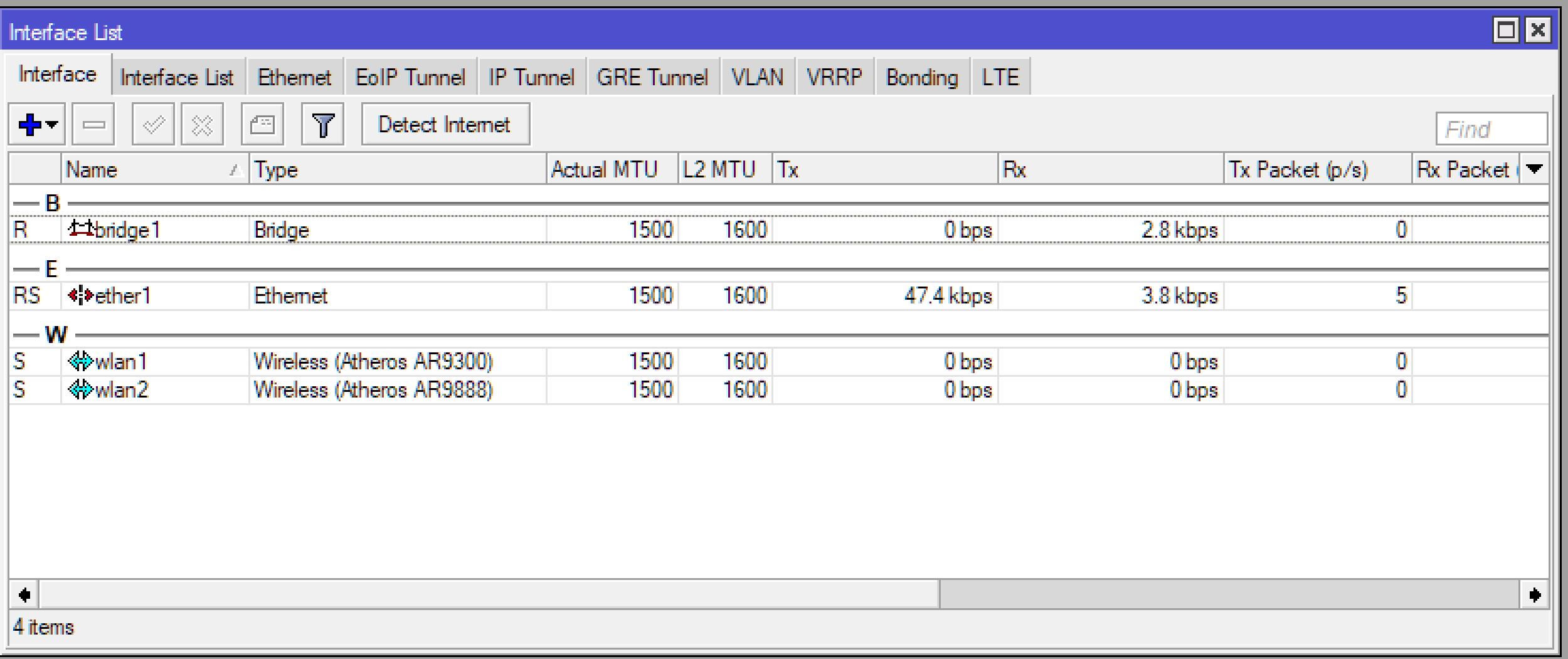

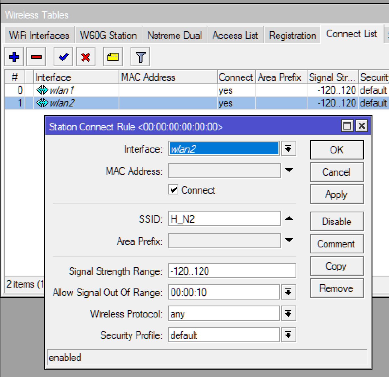

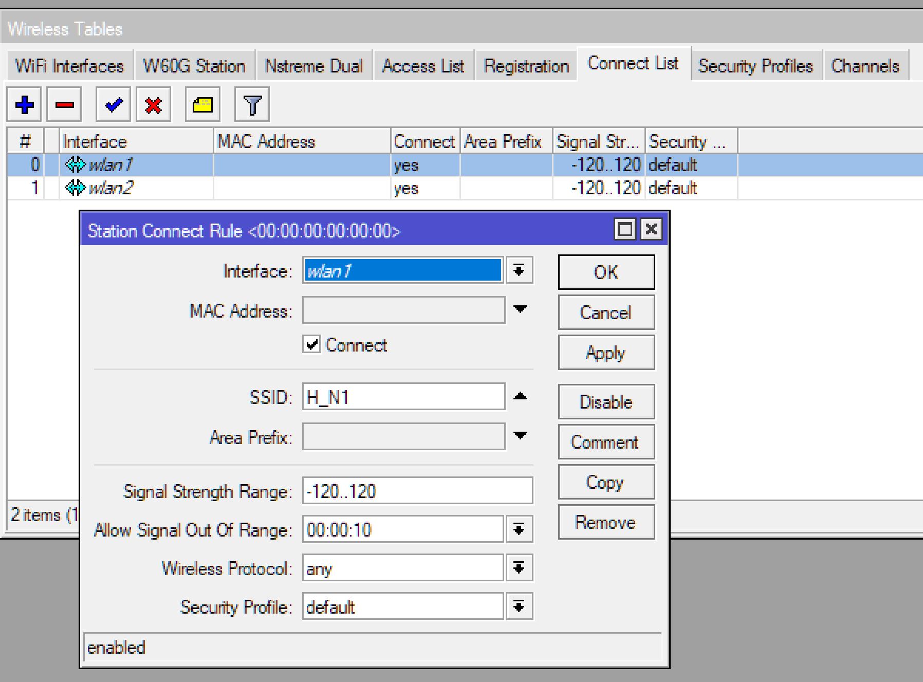

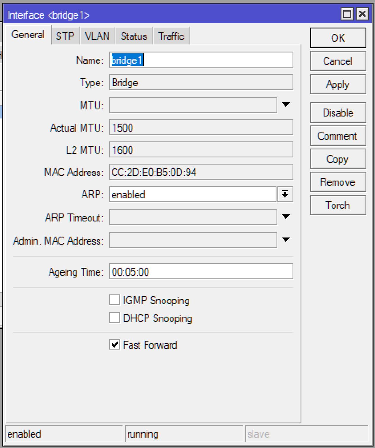

From the bridge setting screens … “disabled port” is OK, as nobody is connected. The WLAN interface is active as you have an actual MTU.
What you do under “connect list” is better to just set “Default Authenticate” and “Default Forward” in the wifi interface and remove the connect list. Connect list is the list of AP’s these WLAN interfaces can connect to as client (=station). “Acces list” is the list of devices that can access these WLAN interfaces. “Default Authenticate” and “Default Forward” is to allow access even if the client device does not match any “access list” criteria. The way to start is with the defaults.

Remember also: WLAN’s and ether1 are slave interfaces of the bridge. IP settings (address, DHCP, …) should all use the bridge as interface.

and … WLAN interfaces must be in “ap bridge” mode to broadcast their SSID.
