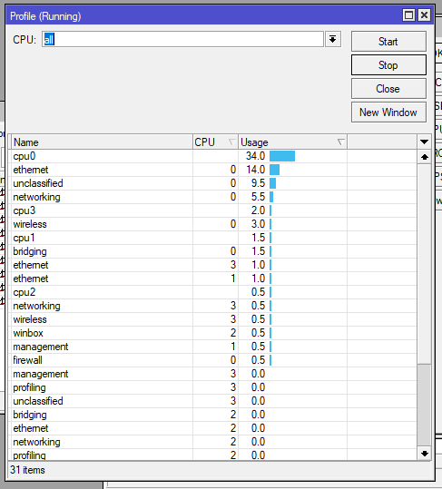

capsman’s CPU is like

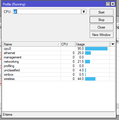

wAP’s CPU is like

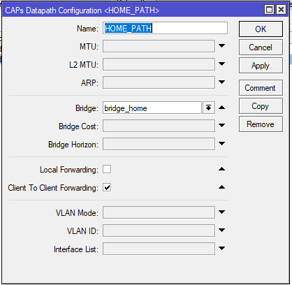

capsman’s datapath is simple
Do you need to run the traffic locally through manager? The traffic is being tunneled back to the manager hence where the CPU usage is coming from, without tunneling you should get full speed.
Thank you for the info, but I tried local forwarding, the speed improves 2M/s, wifi and networking still eat up all the CPU.I notice there’s no switch chip in wAP ac, the data forwarding between the Ethernet and WLAN has to go through CPU.
