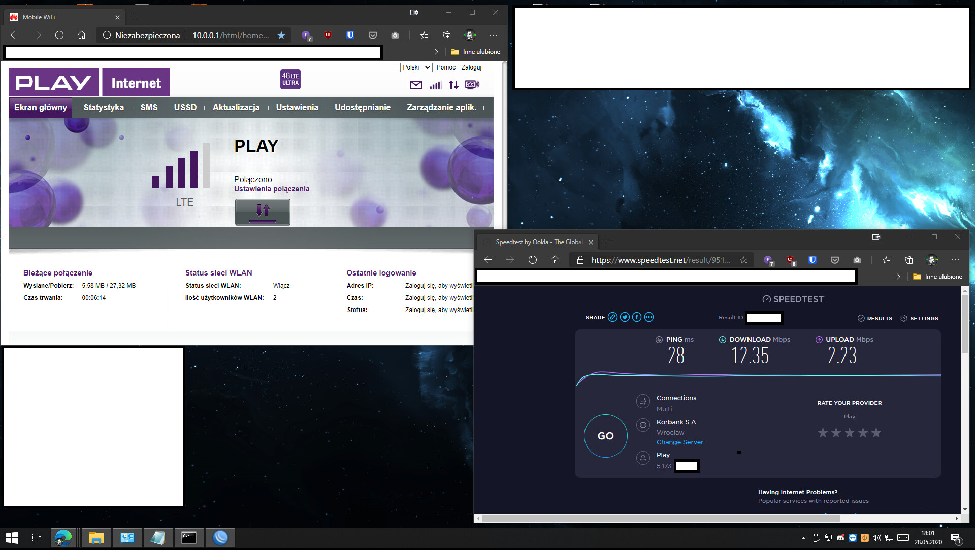

Hello, I bought the WAP AC LTE6 kit (wAPGR-5HacD2HnD&R11e-LTE6), hoping that I’d get at least the same speeds compared to my ISP’s router, Huawei B525. However, the difference is drastic.
The Huawei router reaches 12.3 Mbps download and 2.2 Mbps upload, which is quite bad for LTE, but that’s the speed it consistently reaches in Speedtest.net.
The Mikrotik router reaches barely 5.4 Mbps and 1.5 Mbps upload, so it manages to perform even worse! Even though the device stands in the exact same location the Huawei router did and uses the same exact SIM card. Why would it perform worse?
I’ve tried changing bands around but I haven’t gained much. One of the bands allowed me to pull 8 Mbps but only push like 0.4 Mbps, that’s not a compromise I’m willing to take. And besides, this device has an LTE6 modem, shouldn’t it be using multiple bands just like my Huawei router does?

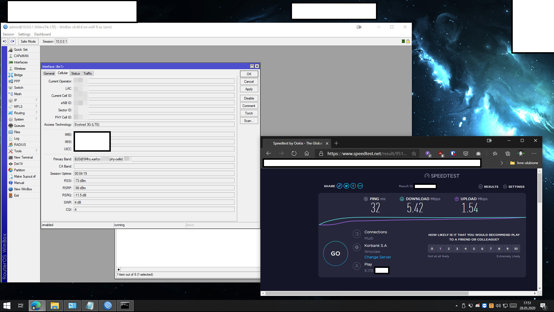

I’ve upgraded the device to the latest stable RouterOS version. Changing the MTU between 1400, 1480, 1482 and 1500 provided no improvement. I’m attaching screenshots of speedtests done with both devices (connected with a 1 Gbps Cat6 cable) along with cellular information from both.

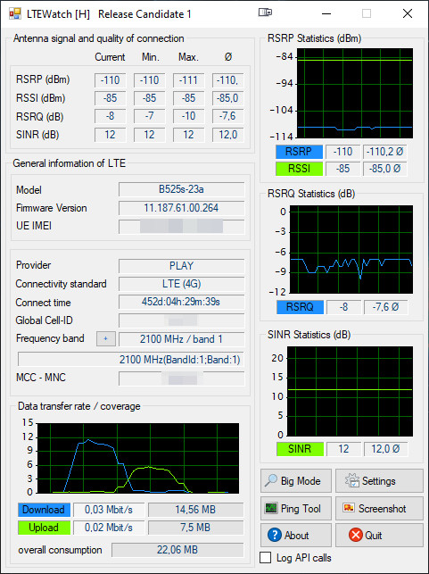

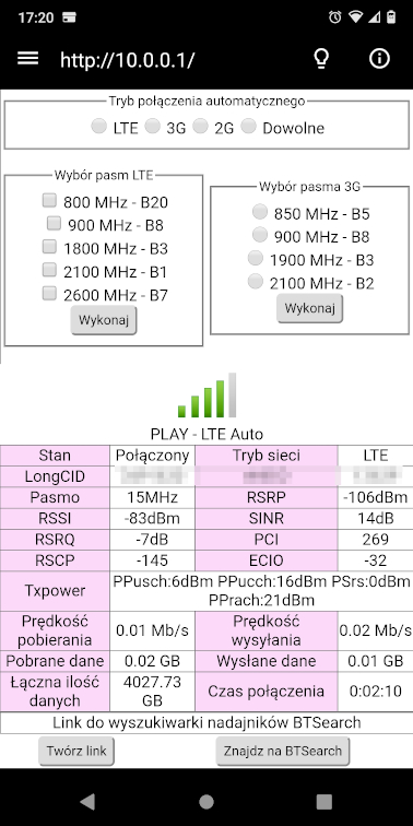

easy, HManager show you a CellID, at BTSearch.pl you can found that cellID and what Frequency it was.
Set at LTE6 the same Band and check speed.
You should check all tree band’s and compare speeds.

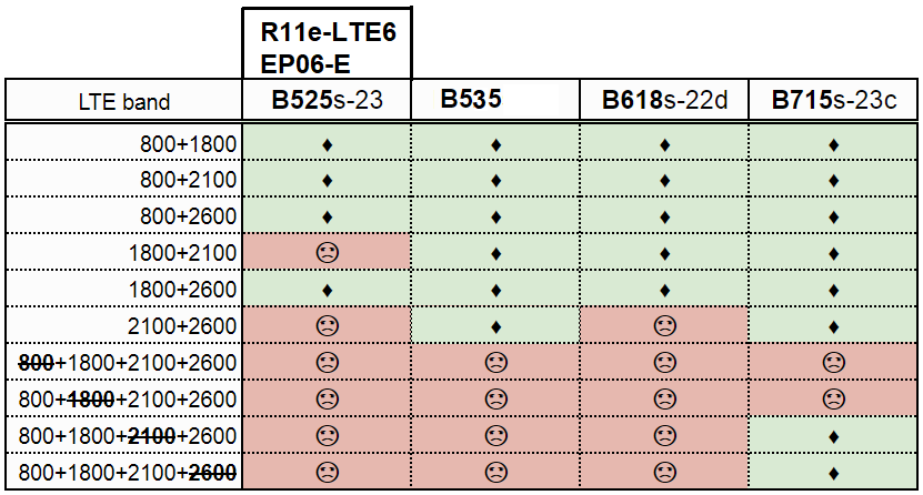

r11e-LTE6 can do in speed freq only 2CA: B3+B7 (1800+2600)
Slow + fast like B20 + (B3 or B1 or B7)
B525 have the same posibility, check this: http://forum.mikrotik.com/t/future-of-lte-products-user-feedback-requested/117022/1

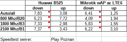

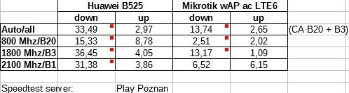

The results are in, but I think I should re-do the test in the morning, since even with my Huawei router I’m getting results that are already sad to look at, and I’m thinking the differences might be within a margin of error. In the morning my speeds should be much better, might underline the difference more clearly.

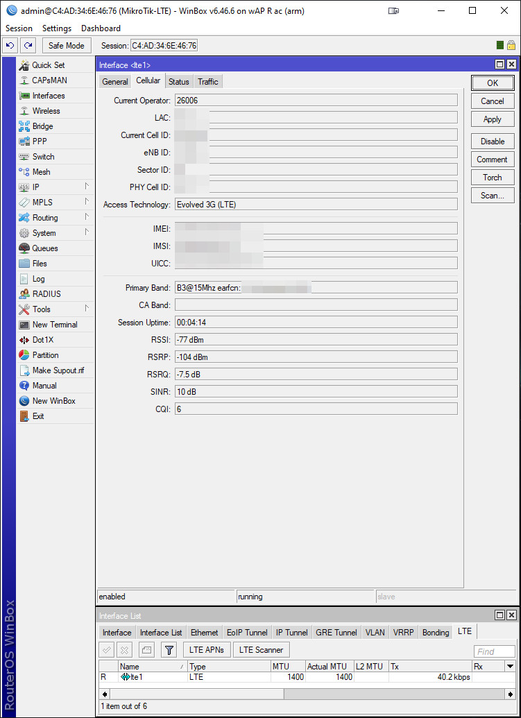

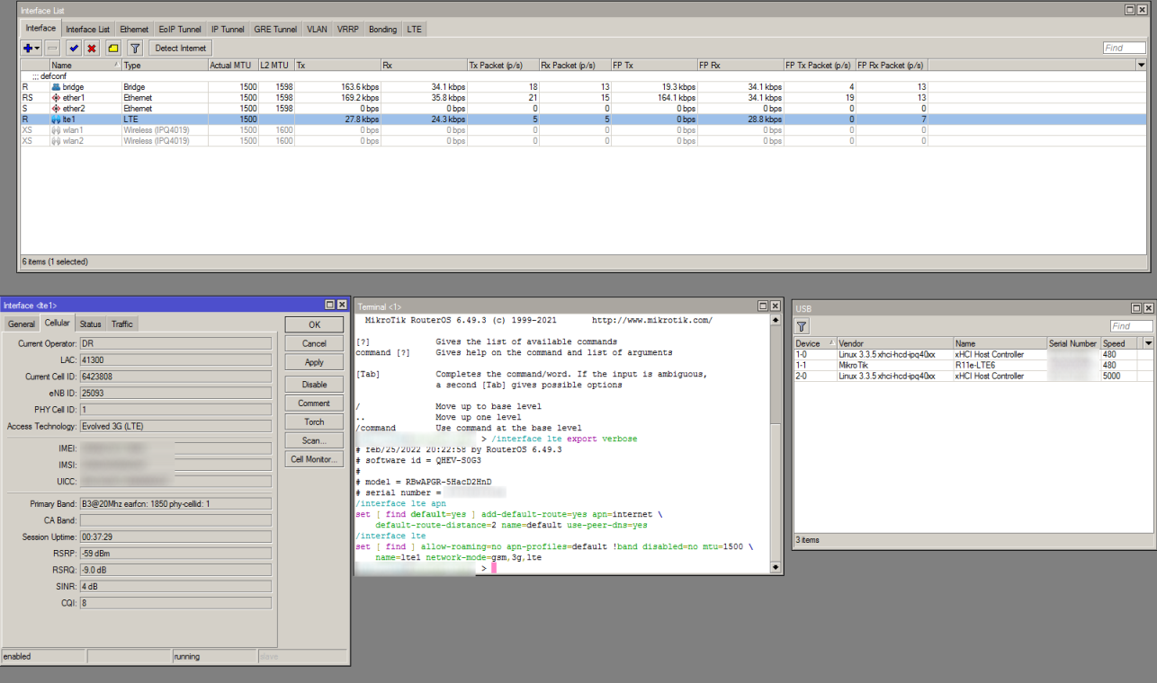

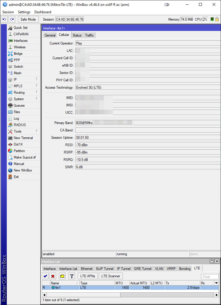

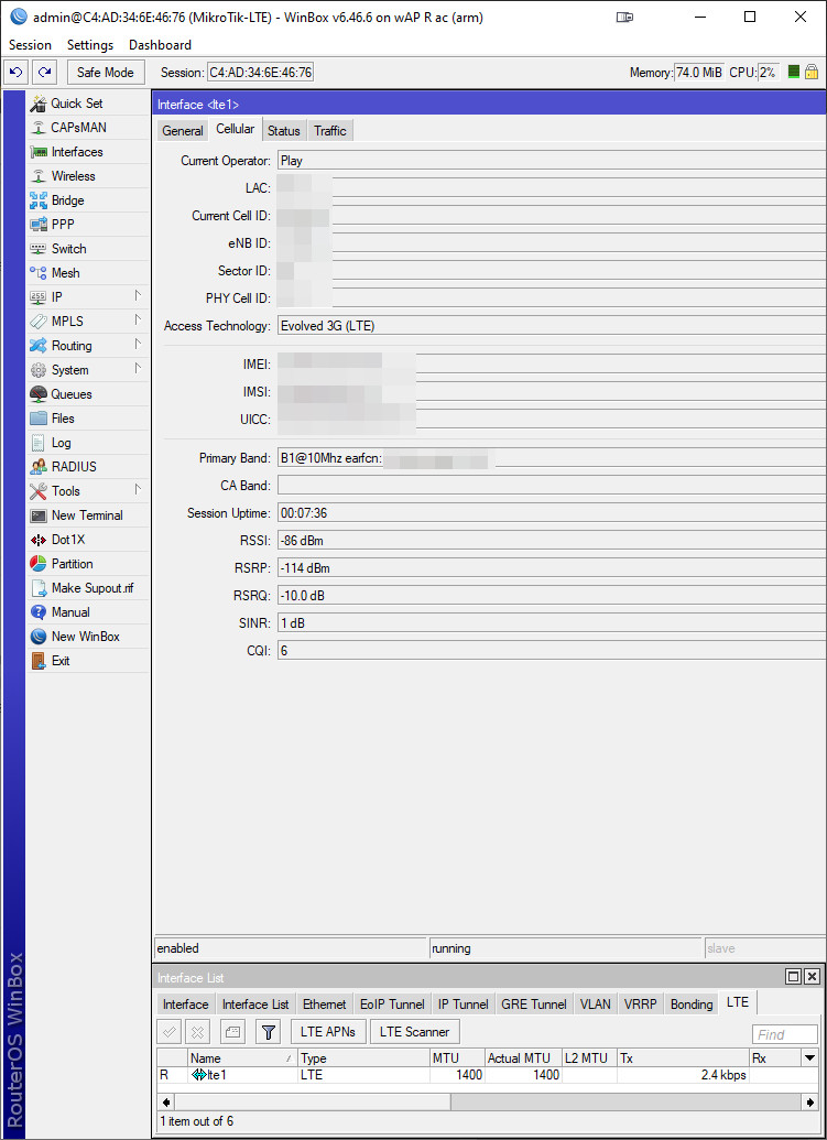

Cellular info below. I say these forums really need a [spoiler] tag so these images don’t stretch the forums so hard… Would make it easier to navigate. The file names under the images are self-descriptive.
And here’s the test done in the morning. As I was saying…
Severely disappointed. I’m ready to return this device if there’s no way to fix it til Monday…
If the integrated antenna of WAP AC R are the same of the old WAP R they are weaker than the integrated of B525.
I used both WAP R and B525s (now i’m using LHG R). At my house i have poor reception and i used external directional antenna with them.
The Mikrotik and Huawei performance are almost the same with the same external antenna (Huawei already have sma connectors, WAP needs optional ufl-sma pigtails).
Just change the antenna and you’ll have very good performance with Mikrotik. The advantage is the great number of information and options for the modem (i can’t use modem with only auto setting here).

Depending on the cost, I thinking returning this and getting a Huawei B535 might be a better option for me, so I can aggregate B1 and B3 bands for potentially much higher speeds…
You not read a post what I write… the B535 and wAP R ac + LTE6 have the same band agreggation possibility. B618 have got B3+B1 but not B535.
wAP R ac have bad internal antenna but can be mounted outdoor and B535 cannot.
To both you can install external antenna to reach better speeds, ATK 504 or CyberTech - read about them.
I’m sorry since I’m getting mixed responses about this (I also asked for advice on my ISP’s forums), but are you sure you’re not mixing up B525 (LTE6) and B535 (LTE7)? The first one is present in the table you sent, and I understand it will not aggregate 1800+2100. The second one isn’t, and some quick googling of “huawei b535 aggregation” shows people talking about this device aggregating these two bands, and I was also told by someone else that this device is capable of it. But I couldn’t find any proper information about it, so… How is it?

Yes, I miss the one digit… sorry.

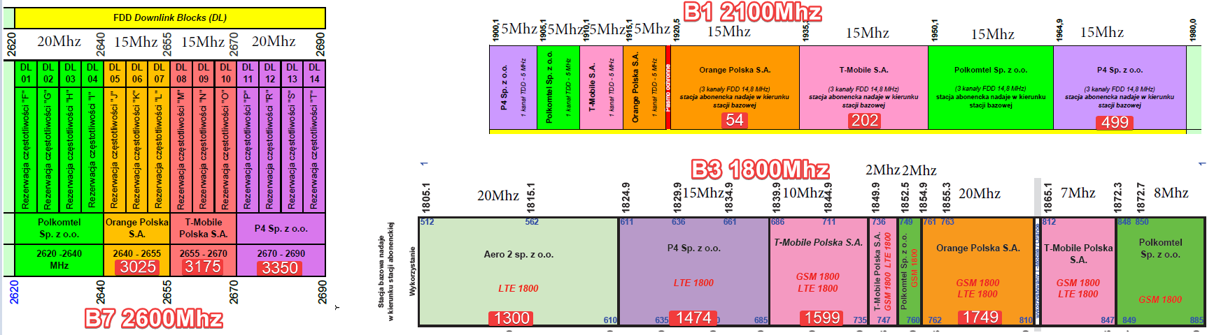

I modify picture to this:
base at: https://www.elektroda.pl/rtvforum/topic3659742.html
UKE ściągawka:
Huawei B535 it is then, thank you so much :slight_smile:
