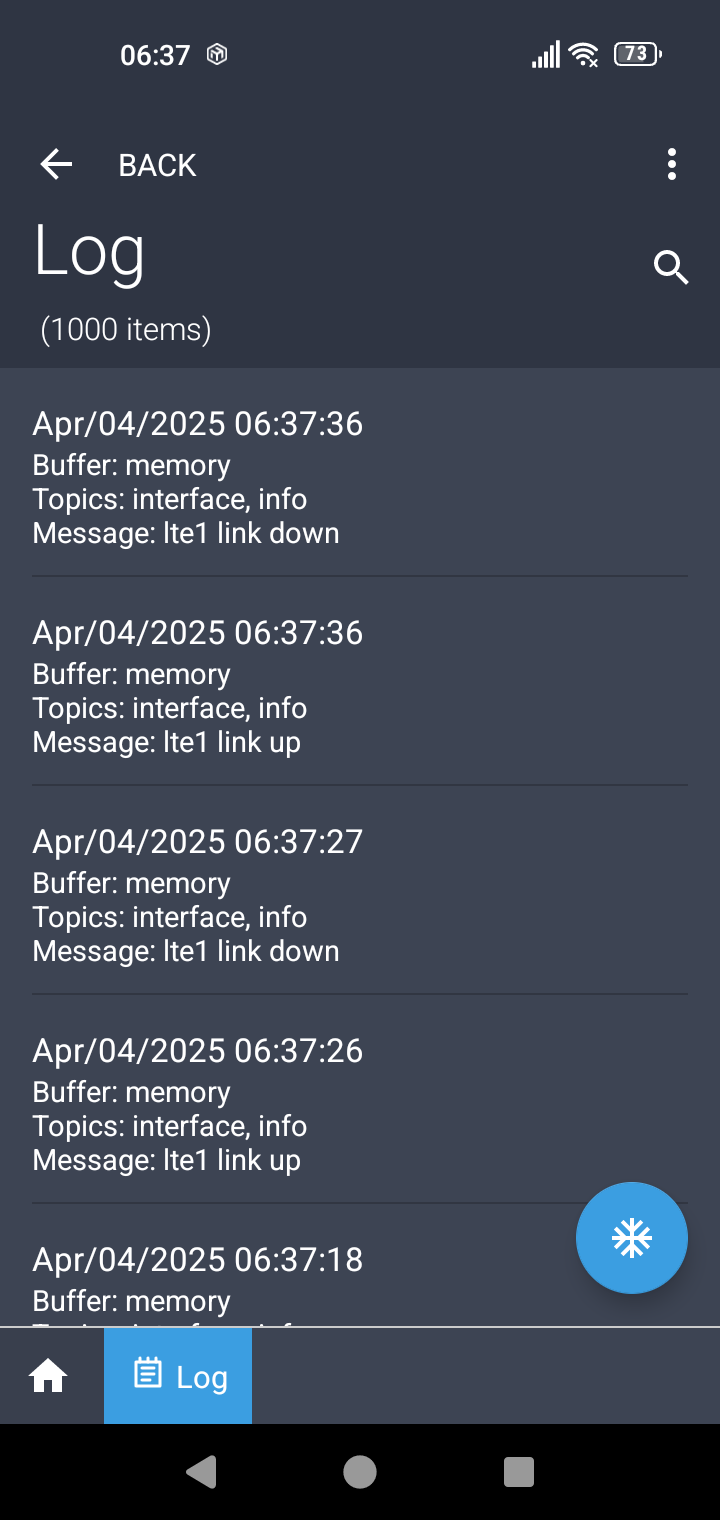

I have wAP ac LTE6 Kit (RBwAPGR-5HacD2HnD&R11e-LTE6), a few years old, but almost never used.
Other day I updated RouterOS to latest stable 7.18.2 and latest LTE interface firmware (don’t remember version).
I reseted configuration to default, and poped in a A1 Croatia ISP SIM card.
Everything was working great, LTE signal is OK, WiFi is working OK.
But after a few hours of operation, about 10 hours, internet is not working.
After power reset everything works OK again.
This morning after another internet fail I connected to MikroTik with my phone, and saw logs flodded with messages every few seconds that LTE interface is resetting.
Did anyone had similar problem, do You think this is RouterOS / configuration problem, or hardware problem ?

As suggested by the woland, over the weekend I downgraded RouterOS to v7.15.3 and for 55 hours there was no issuses, 0 links down on LTE interface, so i think there is issue with the wAP ac LTE6 Kit and RouterOS v7.18.2.
