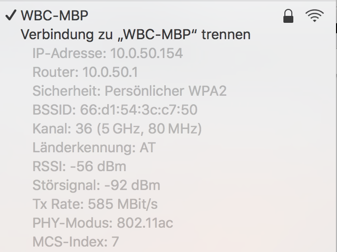

Now, if I connect wit my MBP to the wlan2, than it see some big bandwidth loss from (on average) approximately 700 Mbps (1,000) to 60 Mbps what make me not that happy :frowning:
Is there any miss-configuration in my first step with only vlan1 on the air ?
Here some examples of OK and NOK:

I cannot see how wireless speed could be related to bridge/switch configuration method. Do your printouts come from a tool which really measures the speed or it just analyses the negotiated modulation schemes and translates that into speed information? As it only shows Tx speed, and as the MCS (modulation coding scheme) index is also displayed there and differs between the two siituations (software releases), I’d assume it is the second case. Mikrotik also constantly changes the wireless drivers between software releases. These changes usually lead to better speeds but it may not always be the case. I mean, it seems more likely to me that some other difference between 6.41.2 and your previous version than the bridge implementation is responsible for the wireless speed decrease between the versions. On the other hand, if the new bridge implementation is responsible, I’m afraid it does not depend on bridge configuration.
Check your wireless interface settings to see whether MCS index 7 is permitted at all.
As for the configuration, the VLAN ID related settings on the “/initerface wireless” itself and the “/interface bridge port” binding are in a way duplicate to each other - when you set vlan-mode=no-tag on the wireless interface, the binding rule will ensure that tagless packets from the wireless interface wil be tagged when getting to the bridge with that rule’s pvid value; when you set vlan-mode=use-tag, the packets will get tagged already at the wireless interface so the pvid value of the binding rule becomes irrelevant for them on the way from wireless to bridge. I can imagine, however, that such settting may lead to frames from bridge binding’s pvid being sent tagless from the bridge to the wireless interface along with those tagged with wireless interface’s pvid (but I guess that a wireless interface with vlan-mode=use-tag ignores tagless packets coming from wired side so if this guess is correct, setting identical pvids at the binding and at the interface and setting vlan-mode=use-tag at the interface should break the bridge->wireless path).
For this part of configuration it doesn’t matter whether the wireless interface is the physical one or a vAP, any you have to make each vAP a member port of the bridge individually - the fact that you’ve made the “physical” AP a member port of a bridge does not mean that vAPs running atop that physical AP will be connected to the same bridge.
As for the ingress filtering etc. settings, my guess is that they are only relevant for physical ports so it is not important how you set them for wireless interfaces.
You’ve written somewhere that you have created an /interface vlan with vlan-id=1; I believe it is not necessary because you can use directly the /interface bridge with pvid=1. I was even not sure whether the existence of /interface vlan doesn’t cause some issue as it has the same MAC address as the brdge itself, so I’ve tested and it did make my router inaccessible.

In this case, if you still systematically cannot get higher than MCS#1/79 Mbit/s on Tx, the issue is not that the MCS would not be permitted but rather that there is some issue in MCS negotiation between the Mikrotik and the particular device.
