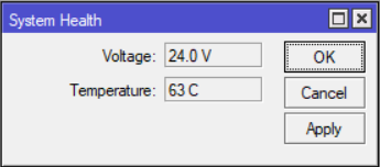

Device temperature sensor stock: ~63 degrees Celsius (after several hours of usage)

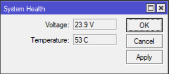

Device temperature sensor with “hack”: ~53 degrees Celsius (after several hours of usage)

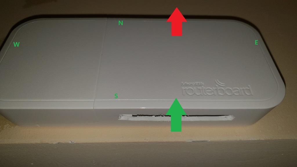

I cut a hole on each side of the unit to allow air convection. The unit is mounted horizontally on the wall.
I know the cut looks ugly, but this was just a proof of concept. I will use a router to cut the hole.
10 degrees for just two holes is a win in my book and can make a difference in hotter ambient locations, where 10 degrees more might result in a lower performance then expected or even a non functioning device.
If you drilled several holes next to each other (making a little grid), it would have same function but nothing could fall inside.
