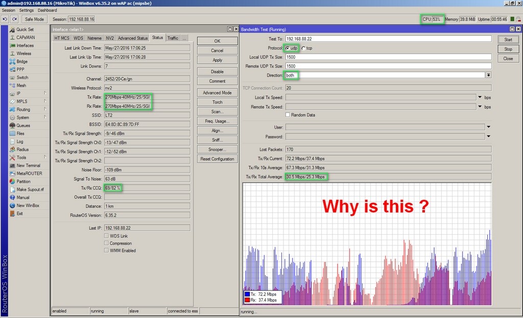

I’m testing a new MikroTik wAP ac (RBwAPG-5HacT2HnD) and see what the traffic is uneven, intermittent, with large and frequent failures of the signal.
Testing was done in the same room at a distance of 3 meters between devices with TX power=1dbm:
What’s the problem? Why is this happening?

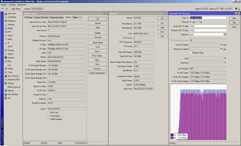

Because with other devices under the same testing conditions that does not happen. For example I recently tested LHG5 and has a good traffic:

A signal of -9 is far too strong and is likely causing some overloading / induction somewhere. Try moving the devices further apart.
